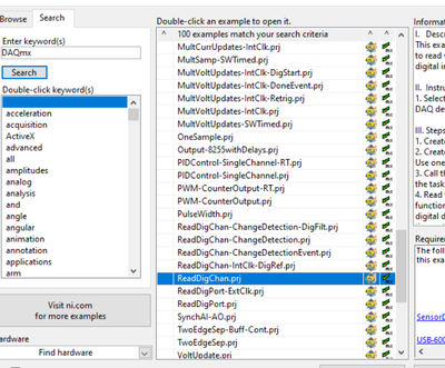

Open CVI,
Go to Help menu.
Go to find examples.
There are various examples for analog and digital channels.
Alternatively on the bottom left side you can enter your hardware details and then do a specific search wrt your hardware controls.
Hope this helps.

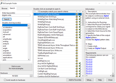

I think you meant state change of D I/O.
Do a search of digital read or digital write :
Hope this helps.
