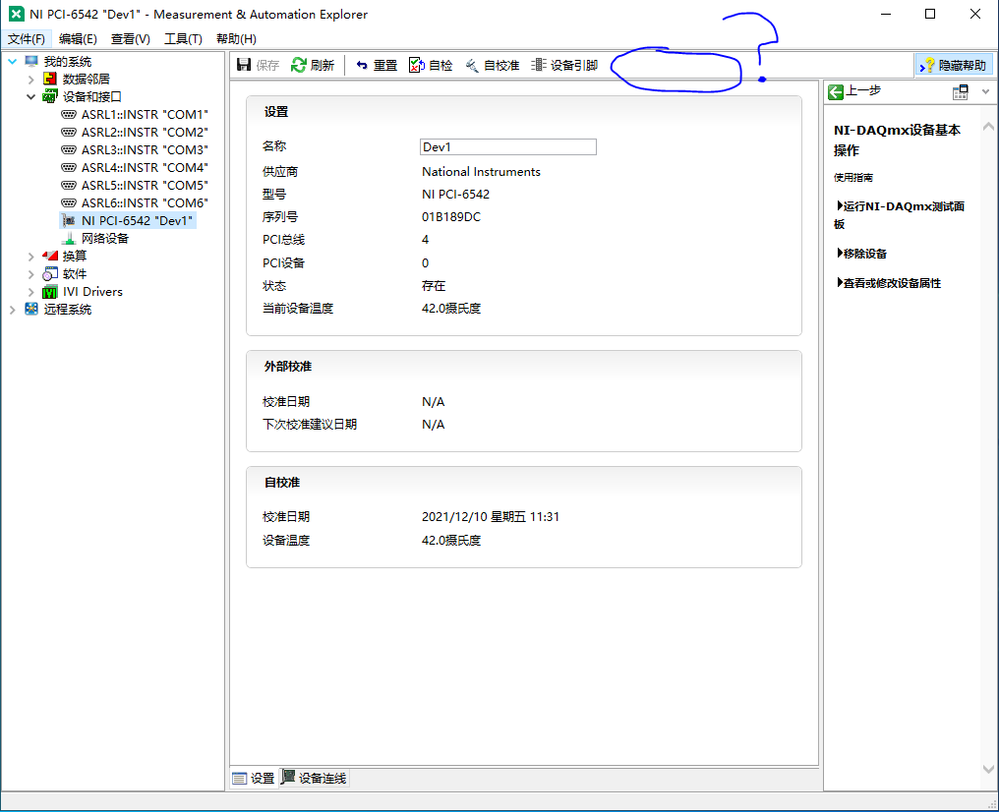

I try to use a PCI-6542 with my computer. After intalling the drivers, I can't fint the front panel button in NI-max. What should I do to fix that?

PCI-6452 uses NI-HSDIO drivers and as of v19.0, NI has stopped support for test panels - https://knowledge.ni.com/KnowledgeArticleDetails?id=kA03q000001DmjFCAS&l=en-US
https://forums.ni.com/t5/PXI/PXIe-654X-Test-Panel-no-Longer-in-NI-MAX/td-p/4006046
If you're using NI HSDIO v19.0 or higher, you will not have Test Panels in NI MAX, you've to use the shipping examples of LabVIEW or C other languages.
You can downgrade to v18.5 or older by uninstalling v19.0 first and installing older drivers.
