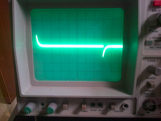

Hi Chris,
I've got the PWM program from the White paper working but when I hook it up to an oscilloscope I am not seeing a square wave, instead I'm seeing the following (apologies for the picture quality & unfocused reading on the scope, someone changed the settings while I was away)
The trailing edge moves when I alter the duty cycle so it works in that sense, I just assumed I'd be looking at a square wave. Is this correct or have I managed to go wrong somewhere?
Many thanks for any help,
Josh
(6,316 Views)
Try settting your scope input for DC coupling. It looks like you have it on AC.
Good luck,
Dave
