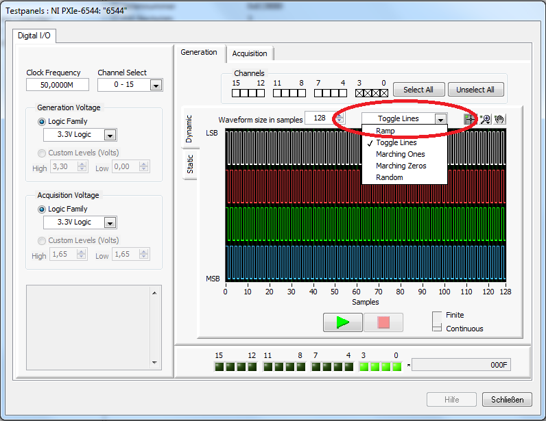

Hallo everyone,
I have a question regarding testpanels of HSDIO in MAX. There is an option in MAX to generate datas in various forms of digital datas:
RAMP / TOGGLE LINES / MARCHING ONES / MARCHING ZEROS / RANDOM.
And most examples using HSDIO are generating the datas using RAMP method. I've been trying to look but I couldnt find the other methods of data generation. I really need the program to generate the data with TOGGLE LINES method. Have tried to use the express gen block, but doesnt help me either. I believe it shouldnt be a complicated built in program, but somehow I cant think what should I do to generate such waveform. I need two channels to generate the same signals like in the picture above.
I have tried generating the ramp and connecting one channel with another one unused channel, but the voltage got dropped and therefore I dont want to use that method. I need later to add delay to one channel, but I believe I can get something from one example from NI (dynamic generation with data delay).
regards,
Yan.

hi, thanks for response.
I'm trying to generate only 2 bits data, and I dont think it has anything to do with square wave generation. The problem is, HSDIO write.vi takes the data that I want to wite in parallel way. For example, we can build 4 steps ramp with:
ch1 | ch0
0    | 0        (numeric: 0)
0    | 1        (numeric: 1)
1    | 0        (numeric: 2)
1    | 1        (numeric: 3)
and I think I just need to rotate the 0 0 (numeric 0) and 1 1 (numeric 3) forever, without including 0 1 and 1 0. I'm trying to look the examples using script. Maybe it can help.
regards,
Yan.

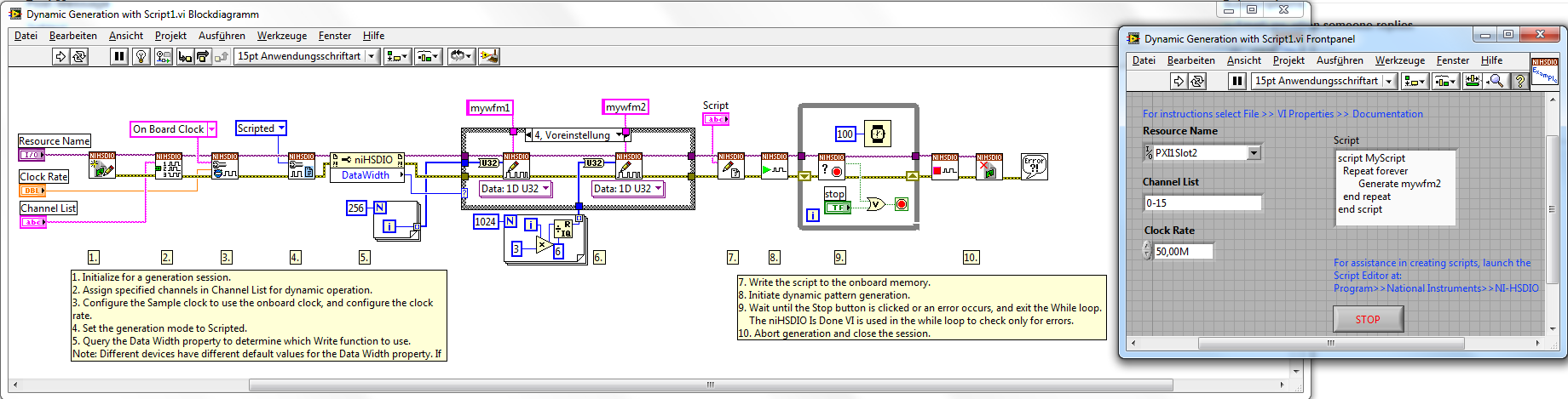

hi,
I've figured it out. With using dynamic generation with script.vi I can manage to get (almost) what I want. The key is rotating 0(binary: 00) and 3(binary: 11) for 2 channels and using script repeat forever.
Or rotating 0(000) and 7(111) for 3 channels.
this trick gives me half frequency of clock rates in both channels, but what I need is 1/4 of clock rates in both channels.
And I need also to find out how to put the delay in one channel.
Any suggestion?
Yan.

hi,
I've managed to get them working properly. Now I need them to work at the same time with a static generation using the same board. I've looked here (http://www.ni.com/white-paper/3528/en) and here (http://forums.ni.com/t5/Digital-I-O/Getting-the-6551-to-do-BOTH-dynamic-generation-ch-0-7-and-Static...
But somehow I cant get the dynamic generation working properly when I assign them in channel 16-31 (I'm using 6544, it has 32DIO). It runs normal in labview, but I dont see anything in ch.16 using scope.
My problem: I need to generate the static value with delay (I'm using sequence structure) using 5 channels (1 channel with delay, 4 channels without) and dynamic signal with using 2 channels. I need them to start working at the same time. But it seems I cant have abort.vi (to cancel out the loop script) working at the same time with static generation (I'm getting error message: invalid task).
