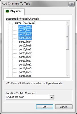

Hi Stripling07,
You will do multiple digital output lines similar to how you do a single line. For four output lines, it will look something like this:
But be sure that you configure your DAQ Assistant for multiple output lines:
Rohan B
Message 6 of 21
(14,037 Views)
It WORKS!! Thank you so much!
