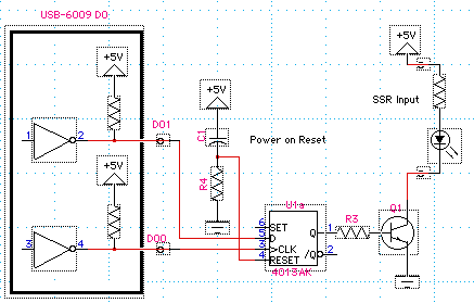

What is the purpose of the external switch?
A circuit like this can be used.

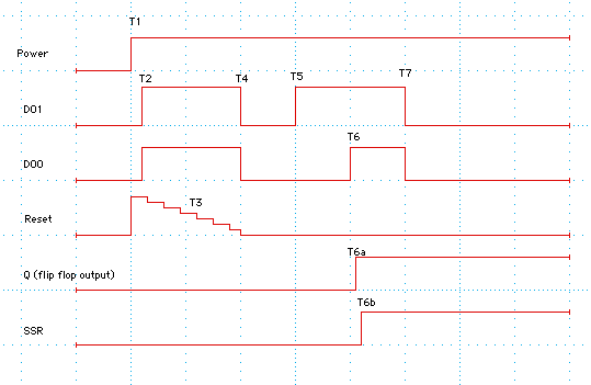

The operation can be understood with reference to the timing diagram below.
T1: Power to computer/USB-6009 turns On. Power on Reset signal goes High.
T2: Digital Port starts up as Input.  Lines pulled High by internal resistors.
T3: Power on Reset signal goes Low.
T4: Program is running and configures Digital Port as Output.  Lines are Low.
T5: Program sets DO1 High.
T6: Program sets DO0 High. This results in T6a: Q output of flip flop goes High. Which produces T6b: SSR turns on.
T7: Program sets DO0 and DO1 Low.
