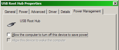

Most issues I have heard with USB instruments tend to be due to the USB hub being powered off due to a Windows "feature".  Go into the device manager and make sure the Power Management for each USB hub has this feature turned off.
(5,549 Views)
First, uncheck power savings in all the root hubs and USB hubs, then check the devices themselves.  Some have them, others do not.
Then try connecting the device directly to the PC and not through any hubs.  Some hubs are better than others, but if you can get that out of the picture, it'll tell you there's an issue with how you have USB devices connected.
