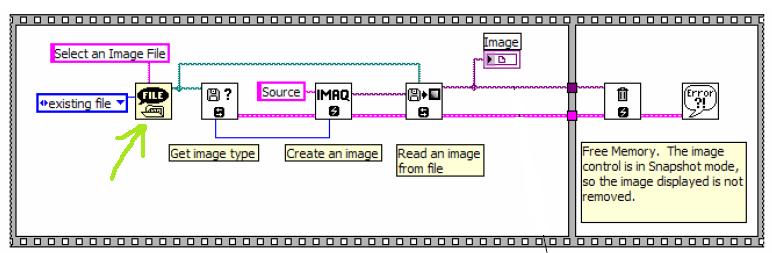

Where do I find this VI, I don't know it's name
Hi everybody, I'm trying to build this example, but I don't find the VI which select the image (green arrow). I think have watched it once, and I don't know even it's name. I thought it was in Standard File I/O but it's not. Maybe it is of an old version of LabView and the icon has changed. I'm using LabView 2009.
Thank you very much.
P.S.. I want to open a jpg file

In LabVIEW 7, it can be found at
File IO -> Advance File Functions -> File Dialog. Not sure about other LV versions.
(3,735 Views)
In fact, many file functions were rewritten for LV8.
You can use File Dialog or Open/Create/Replace File.
(3,723 Views)
Thank you very much both of you. I'd like select both answers as solution, but I can only chose one.
