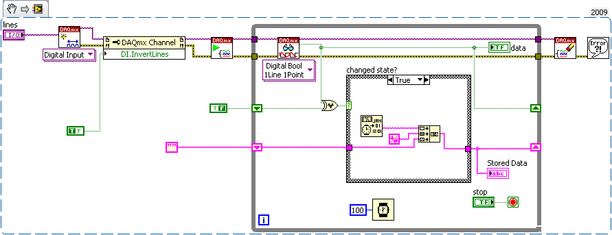

I don't think the event structure is going to work for you here.  I would just is a single loop to read the DI and process it as needed.digital input value change.png
