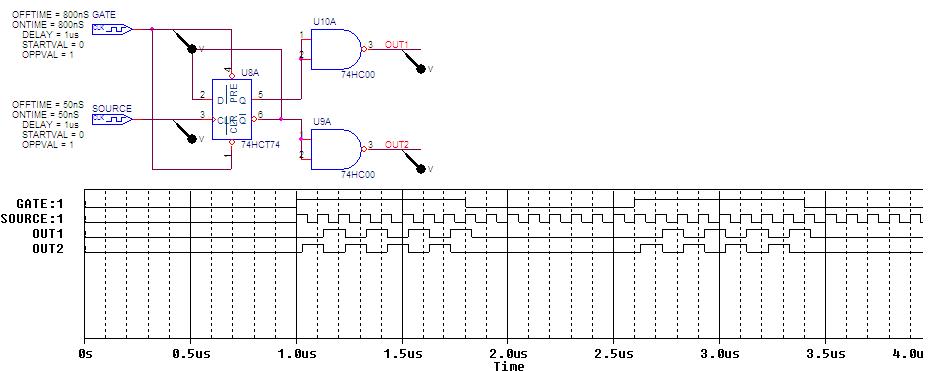

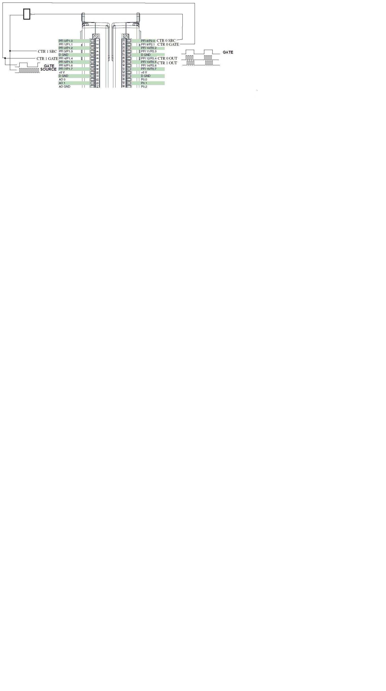

Hello, everybody
Thank's for reply's it  was very helpful. I decided to generate two counter outputs (GATE and SOURCE) and use external circuit to get required signals:
And one more question. Is it possible to get counter0 continuous samle mode and counter1 output finite sample mode?
Then I do this I get just one pulse from counter1 no matter the amount I set .
Thank you forward,
Message Edited by Vytas Bendaravičius on 11-26-2009 12:35 PM
Message 7 of 8
(4,361 Views)
Hi Vytas,
On the 621x, Finite Counter Output tasks require the use of both counters.   You should be receiving an error if you try to run a finite counter output at the same time as a continuous counter output on your board.  However, from the diagram it looks like you might like both counters to run continuously at different rates which would indeed be possible.  Do you need to define the number of pulses generated on the Gate/Source signal?
Also, I noticed that the Source signal you want to generate is 10 MHz.  You may use the Frequency Generator (see 621x Manual) to generate such a signal if you want to free up the use of your two main counters so that you can generate a finite number of pulses.
