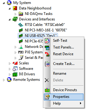

As of DAQmx 8.9, Programmable Power-up States were added to the USB 6525.  However, the flash on these boards was not properly initialized to the "open" state, so adding the check for PPS caused boards to have a default PPS of "closed".  The workaround is to simply set the power-up states to their desired state.  This can be done through MAX as follows:
All boards that are currently shipping have their flash correctly initialized to the open state.
To minimize the chances of this issue affecting anybody negatively during upgrades, we are also adding a check to the firmware loader in DAQmx 9.2.2 and later to initialize the flash if you are upgrading from a version of the driver without PPS.  If upgrading from a version of the driver with PPS, the power-up states will not be affected.
