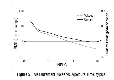

Thank you for the  valuable inputs. I have set my source delay to 10ms and nplc as 1 and the test time now is 33ms. This is what I would be doing on my device. I will be setting
the voltage to a particular value say 1V and I will test around 1000 devices. We will be measuring leakage current in the range of 3-10nA. How accurate will my readings be if I reduce my source delay and also nplc ?
Another observation I made was the very first reading the I make is slightly higher than the other readings . There is a 5% variation in the very first reading. Is this a normal thing or do I have to make some changes to the settings ?
Right now I have set the autozero off.Thank you .

From page 4 of the spec you can see that at 1 PLC, we can expect approximately 1 ppm RMS noise of the range at 1 PLC. This means in the 10 uA range our measurement noise would be 10 pA RMS or 60 pA pk-pk.  However, your DUT + cables will pick up additional noise and you should consider using twisted shield pair wires to reduce the noise picked up in your system.  The shield can be terminated to chassis ground on the SMU side of the cable to help reduce noise appearing in your measurement.
