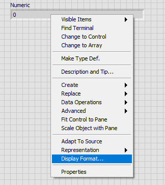

You can go to the same place with "right-click...display format...." (still goes to "properties", just faster :D)

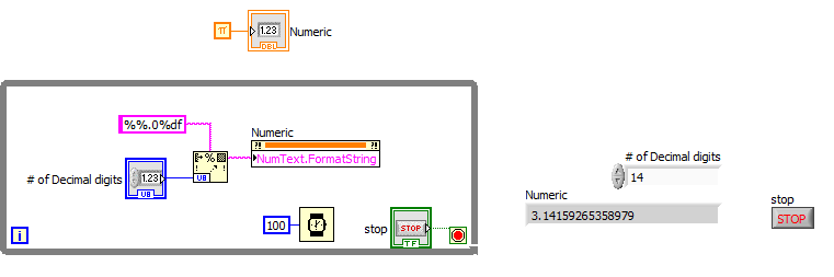

Muchas gracias por tu respuesta, me es útil, pero busco una forma de agregar un control, para unicamente colocar un numero o dato y ese sea el numero de decimales que me muestre.

You can define and change the display format at run time using property nodes, but that requires some code. You could create a control for the number of digits and adjust the format whenever it changes.
You might be able to make an x-control, but that's much more work.

@altenbach wrote:
You can define and change the display format at run time using property nodes, but that requires some code. .
Here's a quick example (of course you need to run the VI.You also only need to write to the property if the value digits changes, so use e.g. an event structure).

Justo lo que necesitaba, de verdad muchas gracias
