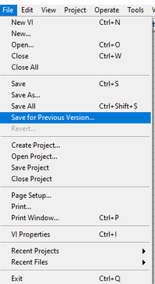

Hola, por favor comparte tu VI en una version anterior, en 2016 por ejemplo. Para poder visualizarlo.

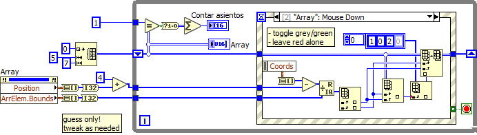

I would make the array an indicator and use mouse-down events. (use the mouse coordinates to calculate clicked array element)
  • If seat is grey, change to green (add to selection)
  • If seat is green, change to grey. (remove from selection)
  • If seat is red, ignore (already taken i.e. unavailable)
  • "Selectionar asientos" will turn the green seats red (tickets purchased).
  • "Reset" will clear all.
No sequence structures! No local variables!
(Use google translate to translate my post)
