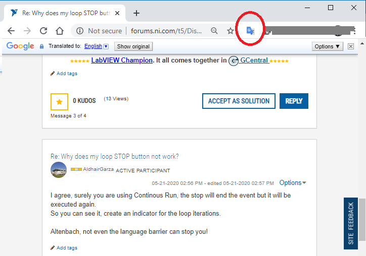

@AldhairGarza wrote:
Altenbach, not even the language barrier can stop you!
No barrier, just google translate chrome plugin.... 😄
