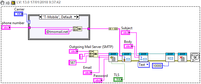

bonjour, si vous êtes francophone merci de poster dans un nouveau post Francophone car le post est fermé depuis 2014. Si vous êtes anglophone, il y a un forum LabVIEW Anglophone. cela sera plus simple pour répondre efficacement. Pour répondre rapidement, il faudra une passerelle SSM de ton provider.
par exemple
  1.  Contact your mobile service provider for the e-mail address of their SMS gateway. Use this address as "Carrier" in the program below"
  2. Choose an e-mail address you would like to use for sending e-mails to this gateway. Insert the details in the "Outgoing Mail Server (SMTP)", "Email" and "Password" fields.
  3. Insert phone number, Subject and message and run the program
Sending SMS Messages from LabVIEW - National Instruments (ni.com)
