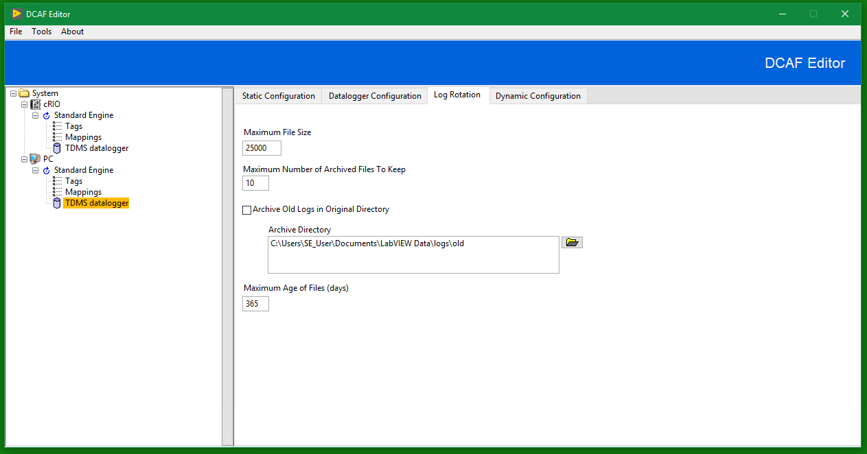

HI Michael, the file is not being deleted it is being archived. In the Log Rotation tab you can see to what folder it got moved.
We should probably add a note in the Hands On explaining this.

So if the behavior feels like a bug, then it probably is.
It makes more sense to require the end user to actively choose to enable archiving instead of having it on by default.
Also, I just noticed you can't turn archiving off. That seems wrong too.
