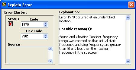

What does error code 1970 signify when using the SVL Power in Band (1 Ch).vi?  Error status is false but error code is not 0.  Does this signify that the frequency range was coerced?

You are correct about that code.  Because the Error status is false, that is a warning as opposed to an error.  You can look up the text that goes with the different codes in LabVIEW by going to Help >> Explain Error:
Please let us know if you have additional questions.
