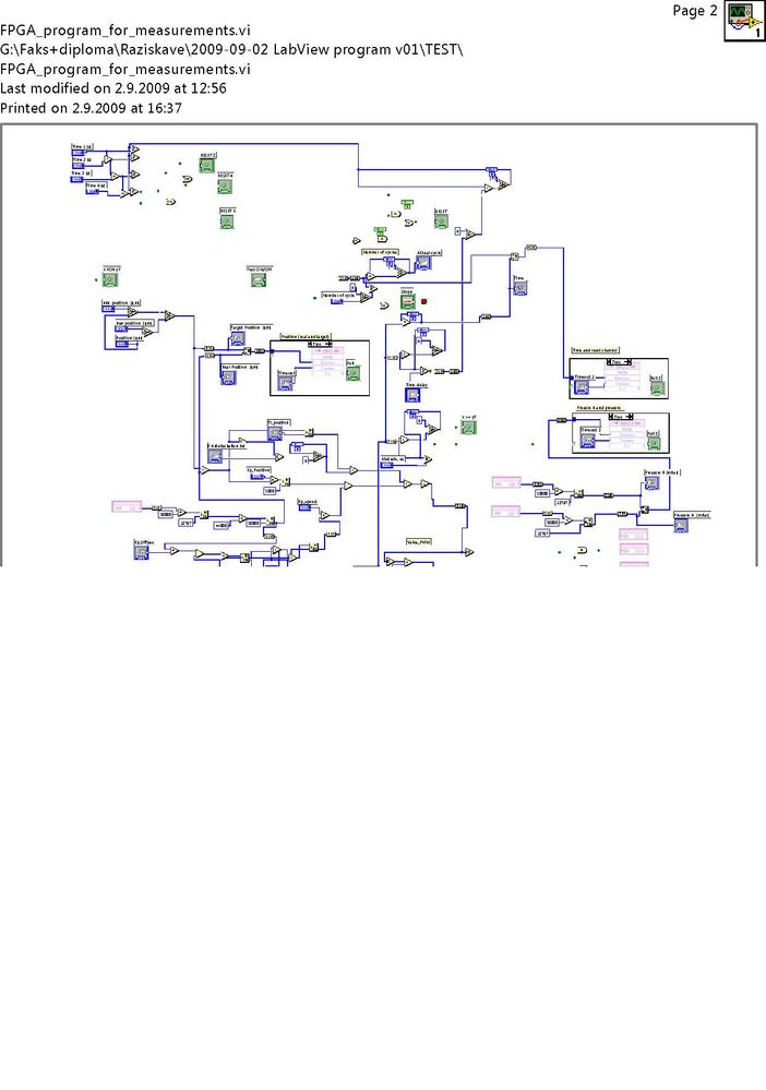

On FPGA program I have all things working fine. Here is picture of this:
And with PC program I controll FPGA program. So with PC program I put values over the global variables to the FPGA program and turn off the measurement and etc. every thing is working fine. I have only problems to put names of the signals, when I want to save.
I am making here measurements and I need to save for each cycle in another file. With function "write measurement file" that was working perfect and with .lvm file you can open it with notepad and you can see results. I tried like it was described on the link that you send to me. And it was working but I don't know how to save in another file and how to open files. Do you need to make anoter program to see results?? or how can you do it??
