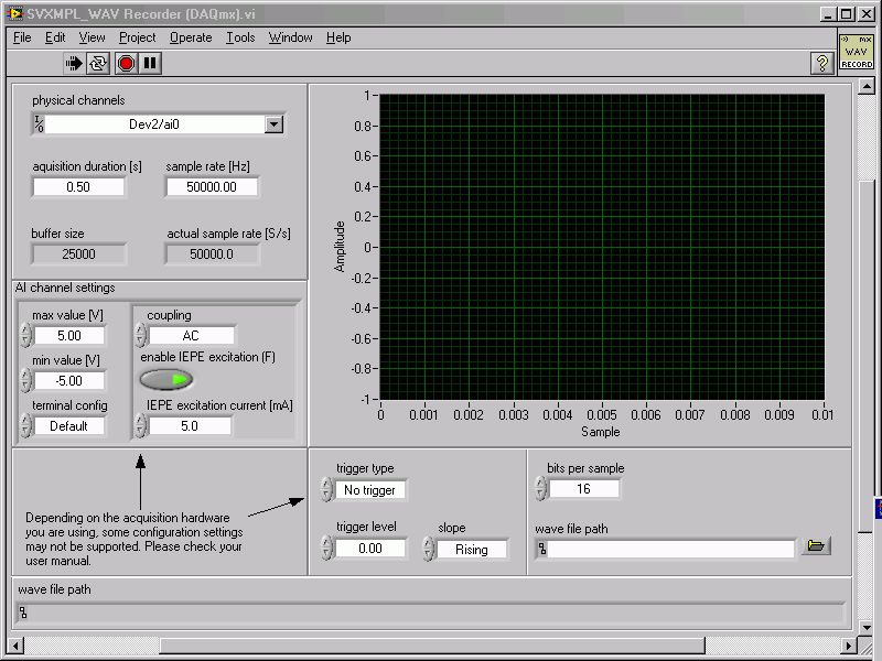

In the shipping version of the Sound and Vibration Toolkit, the WAV Recorder Example pulls the sample rate from the sample rate enum. There is no error checking in this example to verify that the actual sample rate is equal to the specified sample rate. Any coercion should have resulted in an error. In a future version of the toolkit, this example VI will read the sample rate from the waveform datatype and write this actual sample rate to the header in the WAV file. The modified VIs are attached. Please let us know if these VIs work for you.

The "timeout" is currently set in the new vi as being equal to the "acquisition" duration. [ Note the spelling 🙂 ]
The (sample rate) x (acquisition duration) is used to determine the (buffer size) hence the problem.
I set a manual timeout value and it now runs. Thank you for the corrected version.

NI 9233 Recordings are now taken at 50 kS/s or whole number
fractions of this sampling rate. These recordings now can't be played
back using the SV Toolkit SVXMPL_WAV Power Spectrum etc.
If the recording is converted (using 3rd party software) to a re-
sampled rate and then re-saved as 44100 Hz then it can be played and
analysed. Could NI development please review this vi and release a
corrected version for those who have bought the SV Toolkit and need
this functionality?
Thank you
Message 19 of 26
(5,981 Views)
The  expression for the sampling rates for the 9233 is  Fs = 100 kHz/N where N ranges fron 2 to 50, not 50 kHz/N.
