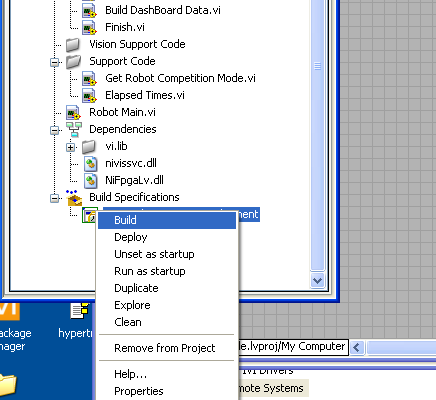

Hey SMM4007,
Do you see the nivissvc DLL listed under the dependencies in your project? The picture below shows how it should appear.

And even after being connected you get the same error?
What happens when you try to Build and then Run the executable included with the project?  Screenshot below shows how to build.
