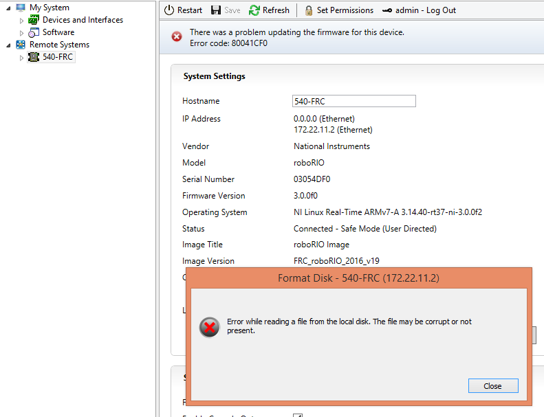

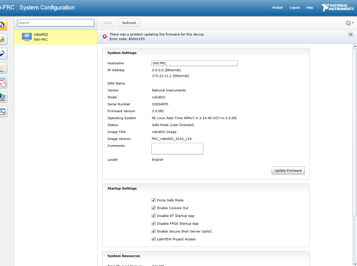

1) Updating firmware doesnt work (in safe-mode):
I always get an error, the same one when updating from NI-Max as when updating from the webserver (if I can connect in the first place)
2) Re-imaging doesnt work
Imaging tool gives this error
3) Reformatting doesn't work!
I was able to find the RoboRIO in safemode with the troubleshoot remote system discovery and then try reformatting.
