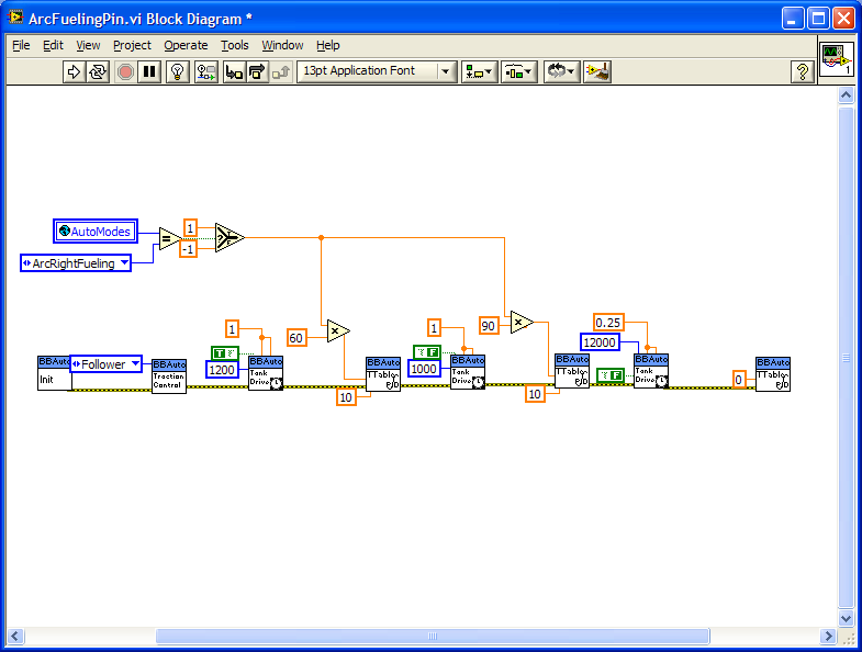

This is basically what we did last year. We broke everything up into subVIs that had a while loop that terminated when it's condition was done. They were sequenced using the error wire.
