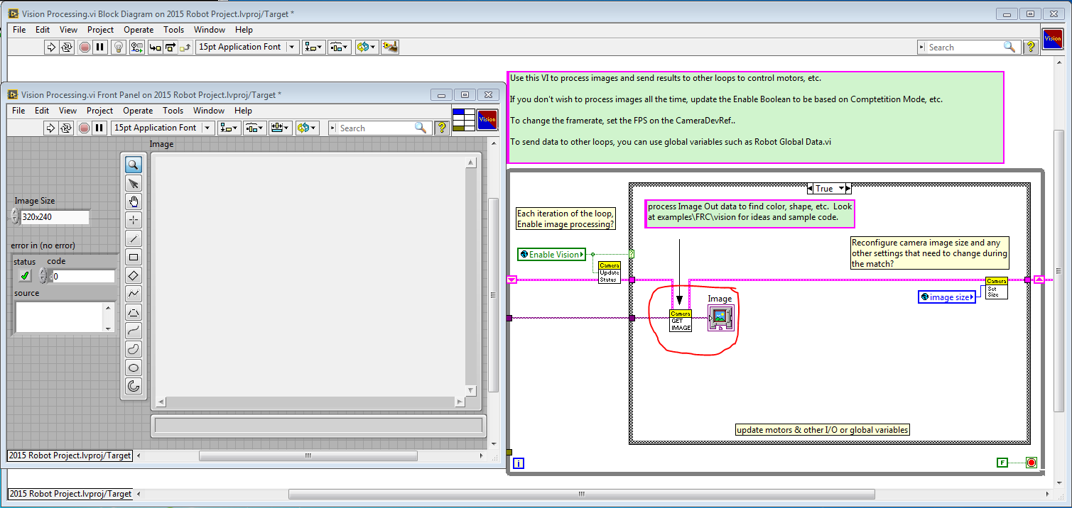

Hostilegato:How are you checking to make sure the camera is recognized by the roboRIO? It sounds like that error could be caused by no specifying the correct USB port for your camera, and thus it is not being recognized by the software. In the Vision Processing.vi in your 2015 Robot Project, check the left most section of the Block Diagram for that VI. You should see something like USB 0, True Constant, and axis.camera.local all connected to a Selector. If you are using USB, you may want to change that USB 0 to USB 1 and see if that helps. If you are using an Ethernet camera, you will need to change the True Constant to a False Constant and axis.camera.local to the IP address of the camera.
Jeringo: Was there any information that came with those errors? Do you specify the camera as cam0 in the Vision Processing.vi? If so, you will need to change that to either USB 0 or USB 1. The WPI_CameraOpen.vi will only recognize the USB port name to create the reference to the camera.
Have you been able to create an indicator for the Vision Processing.vi to check to make sure you are getting video in the code? Here is a quick way to do that. All you need to do is add an Image Display indicator to the front panel of the Vision Processing.vi. Double click the Image Display and it will take you to its location on the Block Diagram. You can then wire the Image Out from the WPI_CameraGetImage.vi for the Image Display. When you deploy the code to the robot, keep the Front Panel of the Vision Processing.vi open, and this should help you narrow it down to either the code or the Dashboard that is causing the problem.
