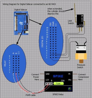

You can find a wiring diagram for the solenoid, compressor and pressure switch if you open the Solenoid With Compressor Example VI. You can also find some information on pnumatics in the FRC 2010 Pneumatics Manual.

Hi Jeramy,
If you open the Solenoid With Compressor example or the Compressor With Cylinder example, you will see a wiring diagram similar to the one below. This is how you should wire up everything together.
