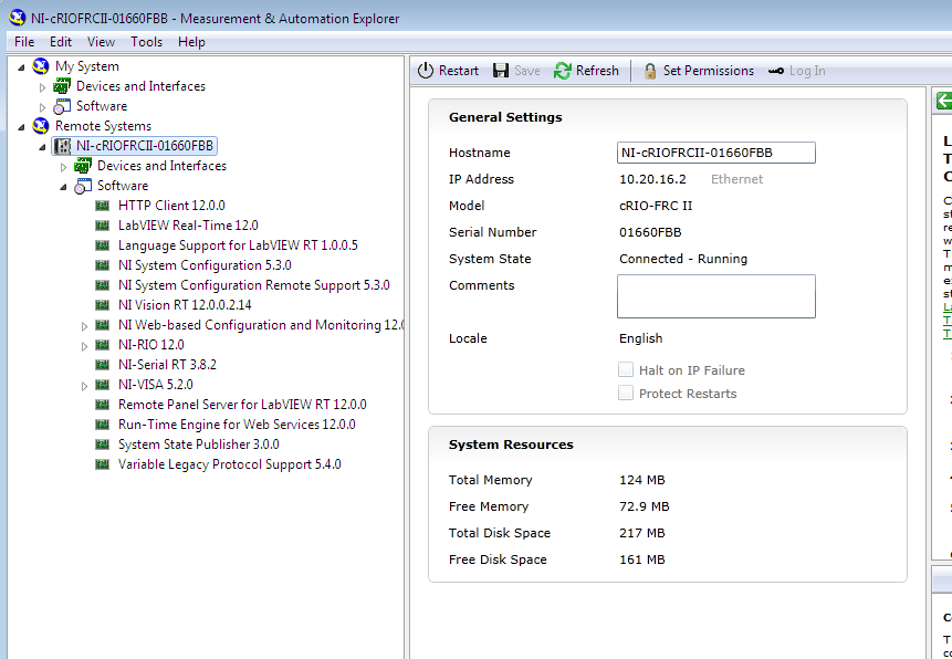

When you look at the cRIO in MAX what does it show for its status and IP Address? What is the IP Address of your computer set to when you're trying to connect with it? Also what software do you see on the device?

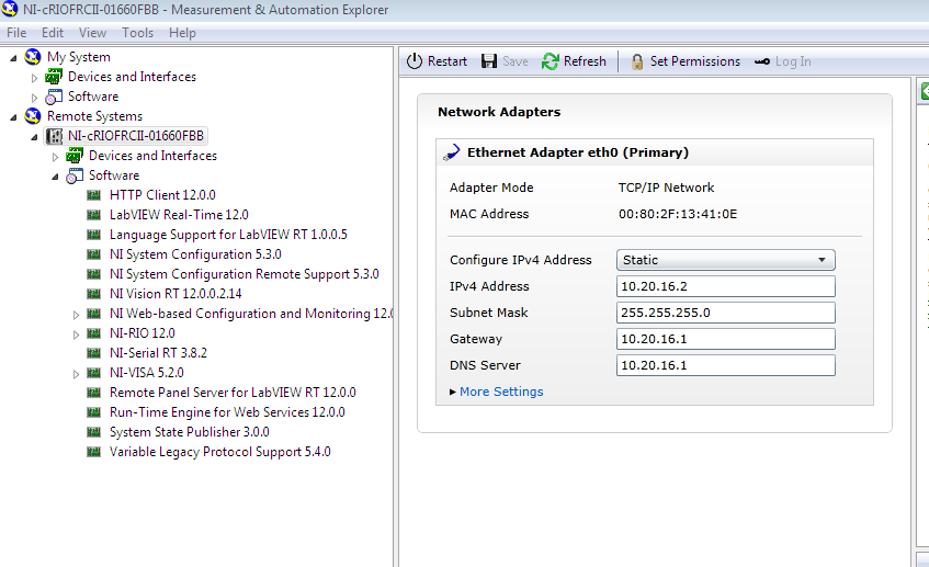

Laptop IP address is 10.20.16.5, mask 255.255.255.0
cRIO Status is 'Connected - Running'
cRIO IP Address is 10.20.16.2
Pls see attached screen shot for software, it includes
     HTTP Client 10.0.0
     LabView RealTime 12.0
     Language Support for LV RT 1.0.0.5
     NI System Configuration 5.3.0
     NI Sys Config Remote Support 5.3.0
     NI Vision RT 12.0.0.2.14
     NI Web based Config & Monitoring
     NI RIO 12.0
     NI Serial RT 5.2.0
     NI Visa 5.2.0
     Rem0te Panel Server for Web Svcs
     System State Publisher
     Var Legacy Protcol Supp 5.4.0

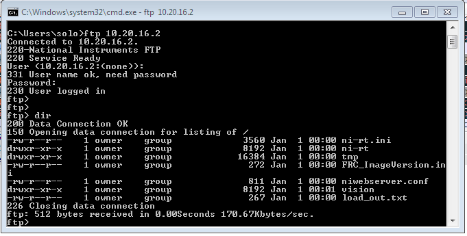

I can also FTP into the cRIO from the attached laptop !!!

Hey Solopilot,
So I have a few recommendations for this issue:
1. Change the Gateway and DNS Server settings on the cRIO to 0.0.0.0 instead of 10.20.16.1. Then try the imaging tool.
