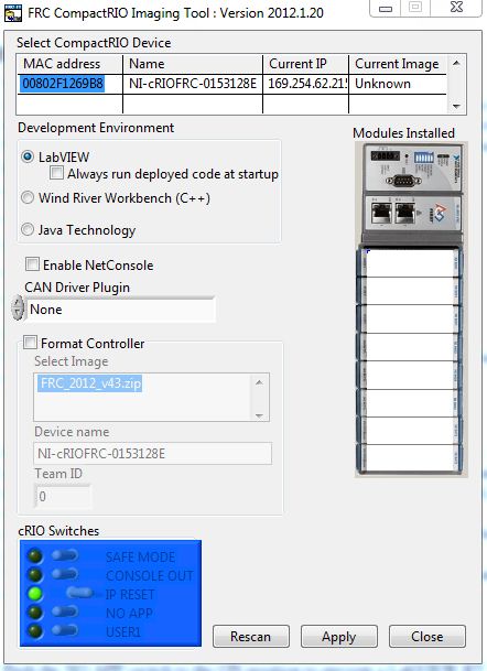

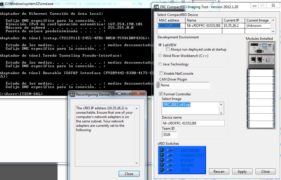

I had already tried an IP reset. However, I had not put my NIC to obtain the IP address, so I did as you suggested. Here are some screenshots of the process:
As you can see, the address that my NIC "gets" or "sets to" is 196.254.190.101. With this address it manages to re-establish the cRIO IP to 10.35.26.2, but I get the same message. Of course, after that I tried statically assigning my laptop's IP address to 10.35.26.6 with no success.

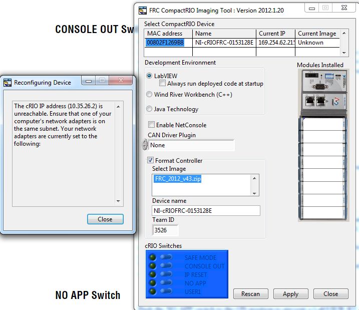

I had tried safe mode & IP reset, but then again, not with the "automatic IP" setting on my NIC. So I did as you suggested.
The result was that the tool asked me to format the cRIO, and I said Yes. Apparently it did format it correctly (took no more than 1 minute) since no errors were displayed. Then it asked me to turn off the safe mode switch, reboot and re-run the Tool. I did that and again I get the same error. So right after that I tried FTP/ping with no succes.
After that I statically changed my IP to 10.xx.yy.6 and FTP/ping it with succes. Then tried again with no succes.
PS: I tried this with all the suggestions -> Off Firewall, Off antivirus, Disabled all other Network Interfaces even Bluetooth. I tried with crossover, then striaght, then trough a Hub.
Here is a screenshot of the correct ping/FTP and error.

After many times of trying we finally got the cRIO working.
Unfortunately the cRIO Imaging Tool did not work for us as intended.
What finally worked was:
1. Format the cRIO using the Imaging Tool, but with the safe mode switch ON.
2. After formatting, the tool tells you to reboot the controller to the re-run the tool again. However, it gave us the same mistake: "The cRIO IP address (10.35.26.2) is unreachable. Ensure that one of your computer's network adapters..."
3. So, instead of using the Imaging Tool as intended we copied manually the files of the "FRC_2012_v43.zip" file trough FTP. All we did was uncompressed the file, then we copied the contents of the Folders "cRIOcommon" and "cRIOFRC" into the cRIO.
4. Then we run the code in LabVIEW, and checked communications with the Dashboard and everything was OK.
PS: Here is proof that after the manual "imaging" the Imaging Tool gets to "see" the version installed, but fails again to format the controller giving us the same mistake. The tool even sees the modules instaled properly.
PS2: Hope someone at NI realizes what this error was since this was definitely a very frustrating and time consuming error.
