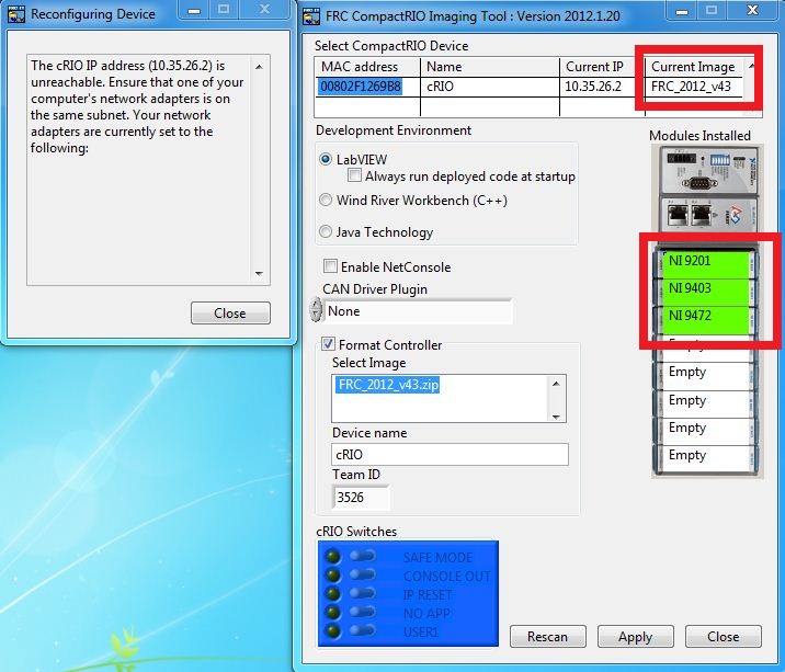

joel.castillo wrote:
PS: Here is proof that after the manual "imaging" the Imaging Tool gets to "see" the version installed, but fails again to format the controller giving us the same mistake. The tool even sees the modules instaled properly.
After doing this, have you tried changing a setting that doesn't require a reformat, such as selecting a different language or selecting a CAN driver plug-in?  Does that part of the imaging tool work?
