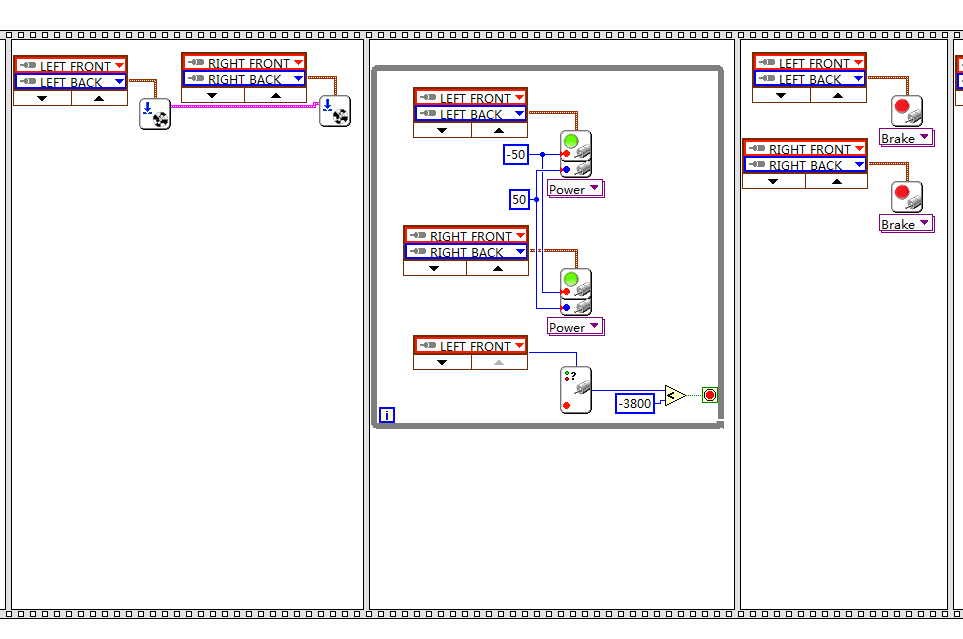

I'm using a set of macanum wheels so I want to control four wheels at the same time to achieve omni-direction moving. But the distence moving always work one by one, so there are only two wheels working at the same time. How can I deal with it?

Are you talking about this when writing autonmomy? I have a attached a screen shot of what I think you want to know how to do.
Each vi can only work with one motor controller at a time.So to operate 4 motors at the same time you will need 2 instances of the vi linked to the sequence of events (NXT pink wire) as shown.

In that case I would try to put the vi's into a structure in the stream.
Some structure where a pink strand feeds in and out.
Maybe a while loop that runs one time - exiting based on completion of both vi's?

well, I have tried many ways, I think it might only works when i creat two sub vi and make them run together, but i haven't try it.
I just use a structure in the picture to read the encoder, though there might be some error between wheels.
Actrually the atunomous program is finished now, and it works really good. we can now do both the ir becon block and the stop on ramp missions.

Jerry:
Is this a sample of code that is working for you? or is NOT working the way you want?
What is the goal of that piece of code (diagonal movement)?
