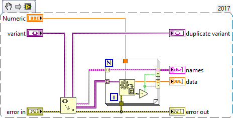

That being said it isn't fully broken and you can still use them.  Okay some of this might be chrome specific.  Find a snippet, right click it and choose open image in new tab.  Now you will have a URL like this:
https://forums.ni.com/t5/image/serverpage/image-id/214063iB57FB649CBEA2ED8/image-size/large?v=1.0&am...
In this address bar remove the image size information to be this:
https://forums.ni.com/t5/image/serverpage/image-id/221797i20374B8583A07B79
Now hit enter.  This image can now be dragged to a LabVIEW block diagram from chrome.
