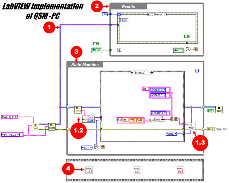

Figure 1.  Shows four objects of high-level QSM –PC architecture. 1= Queue reference;  2 = User events object (producer of commands and data); 3 = Commands processor (consumer process that handles commands and data); 4 = Parallel SubVI processes (producer of commands and data)

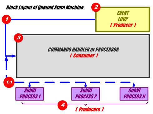

Figure 2. QSM –PC architecture showing data flow and objects inside the consumer process
Figure 3. LabVIEW implementation of the producer consumer architecture. Labeled objects 1 through 4 match those of the high level illustrations in Figure 1 and Figure 2.

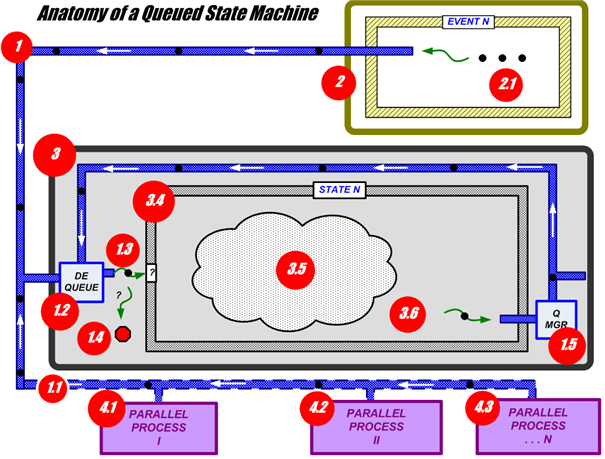

A High Level Layout of QSM-PC Architecture
A typical general layout of QSM-PC architecture comprises of the four objects annotated by the encircled numerals 1 to 4 shown in Figure 1.  These objects are namely: (1) Queue reference object; (2) User events object (optional for head-less embedded applications that require no user interaction); (3) Main state machine object; (4) One or more parallel processes subVI objects. Note that label 1.1 in Figure 1 is a broken-line representation of the queue reference object. The broken-line is meant to show that the subVI processes are able to access and interact with the queue from within the SubVI by referencing the queue by name without having to wire the queue reference to the SubVIs. See the LabVIEW implementation of this illustration in Figure 3.  Queue reference access by name also allows a queue reference to be use by dynamically launched VIs by VI Server and is discussed further under the section: Item (1) Queue Reference Object.
Items (2) and (4) are the multiple producer processes responsible for sourcing commands and data and adding them to the queue. Item (3) is the single consumer process which removes commands and data from the queue and acts on these in the order added to the queue. One important rule is that, for any one queue reference, you should only have one consumer process while there can be one or more producer processes. This rule ensures that the consumer process is the central command processing center where each and every command added to the queue reference gets handled. In the LabVIEW QSM-PC layout of Figure 3  the consumer process is part of the open top level block diagram, rather than a subVI. This is to facilitate manipulation of controls, indicators and properties of front panel objects. The discussion that follows elaborates further on items 1 through 4 and shows their LabVIEW implementation examples.

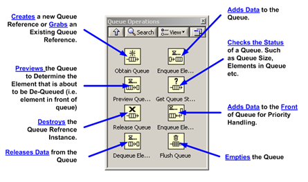

Figure 4. LabVIEW’s queue palette VIs.

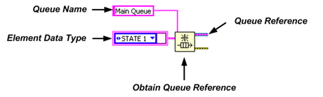

Creating The Queue Reference or Grabing Existing Queue Reference:
The LabVIEW queue implementation shown in Figure 3 creates a queue reference of the name: ‘Main Queue’ using the Obtain Queue VI from LabVIEW’s queue palette; see example LabVIEW code in Figure 5. Subsequent and repeated implementation of this same code will grab an existing queue reference of the specified name. This is typically done to give access of queue reference to subVIs which also avoids the need to wire a queue reference to the subVI.
Figure 5. LabVIEW code for creating a queue reference
Two inputs are essential for creating the queue: (a) The Queue Name: In this example the queue name is ‘Queue Main’; and (b) Data Packet Definition:

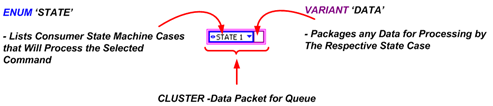

Shown annotated in Figure 6 is a sample data packet recommended for the queued state machine discussed in this article. This data packet constitutes a cluster containing two pieces of information: (i) A type def enumerated constant also known as a Function ‘STATE’ constant;  and  (ii) a variant ‘DATA’ item. This data packet definition means that the resulting queue reference can only carry data elements that conform to this data packet.
Figure 6. Recommended data packet for QSM architecture
... To be Continued
Message 8 of 12
(12,939 Views)
The typedef enumerated constant enlists your chosen names of the state machine cases in the consumer process. Each time a command is added to the queue, the enum should be set to the machine’s STATE name which will handle or process the command. Therefore, the type-def STATE items are like command names that designate which state name contains the relevant code for processing the command. Typical function enum state names: ‘INITIALIZE’, ‘IDLE’, ‘ERROR’, and ‘EXIT’ should be included.
You must make the enum constant a typedef-based custom control so that you can add or remove command items from the enum and have your changes propagated to all instances of the typedef constant throughout your LabVIEW code. See LabVIEW literature on how to create typedef enum constants. Note that alternative queued state machine templates can also use string data elements for commands in place of the typedef enum. However, string-based state machine cases require exact syntax spelling of state names and are also case sensitive. Typed def enums help reduce programming errors because, once defined, you can only choose an item from the available list of valid items.
The second item in the cluster is the variant data element which can carry any data. This data element allows you to package data along with the command for use in processing. Sending data along with the command using the variant data element is optional. Note that alternative queued state machine templates do not include the variant data element which means that only commands can be sent via the queue. You would need to use functional globals or other means to send data to the processing loop.  The variant data element recommended in this QSM-PC architecture gives you a convenient and useful option to package your commands with any data.

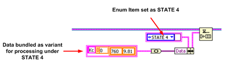

You use the ‘Enqueue Element’ VI from LabVIEW queue palette to add data elements to the queue. The example in Figure 7 (a) is an instance where a producer process adds a data element to the queue with the enum message set as STATE 1 but with an empty variant data. Figure 7(b) is where a producer processed adds a queue data element with enum set as STATE 4 and packaged with a data cluster bundled as variant data. The bundled data is intended for processing by the consumer object under STATE 4. Any data type can be bundled as a variant data making this a flexible way of sending any data in the queue pipeline. The state machine that will handle the data will have to decode the variant data inside the case named STATE 4.  This is elaborated under the section: Item(2) Consumer Object Stats Machine of this article.
Figure 7 (a):  Single data packet added to enqueue VI. STATE set as STATE 1 and empty variant data
Figure 7(b):  Single data packet added toe VI. The STATE set as STATE 4 and variant data packages a data cluster using the bundle by name utility.

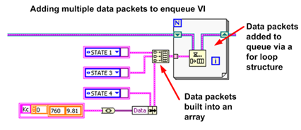

Figure 7(c):  Multiple data packets added by building them into an array and using a ‘For Loop’ to add the data to the enqueue VI.

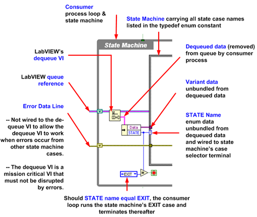

You use the ‘De-queue Element’ VI from LabVIEW’s queue palette to remove data elements from the queue for processing by the consumer object. The de-queue process is annotated as item 1.2 in Figure 2.  After de-queuing, the data packet is unbundled to reveal the STATE name which is wired to the selector terminal of the State Machine.  A case in the state machine which matches the packet’s STATE Name will handle the data packet that was input to selector terminal. The example in Figure 8(a) is a section of the consumer dequeue process taken form Figure 2. A commented section of equivalent LabVIEW implementation code taken from Figure 3 is given in Figure 8(a).
After a dequeued data packet is unbundled to reveal the STATE name, the STATE name is compared with the STATE name ‘EXIT’. Should the comparison be TRUE, the EXIT State will run and thereafter the consumer process loop will terminate executing. This assumes that the STATE name: EXIT, is included in the enum list, and that this STATE name is intended to quit the LabVIEW program
                    Figure 8(a)                                                                              Figure 8(b)
        Consumer process deqeueue                                              Dequeue VI LabVIEW implementation
                    VI illustration
De-Queue VI Unwired Time-Out Input Terminal Defaults to (-1)
Notice that the de-queue VI’s ‘Time Out’ input terminal is unwired and will therefore default to -1. This means that the consumer dequeue process will wait indefinitely or until an element is ready to be de-queued. A way to make the consumer process loop continuously is described under this article’s section: ‘Consumer Object State Machine’.

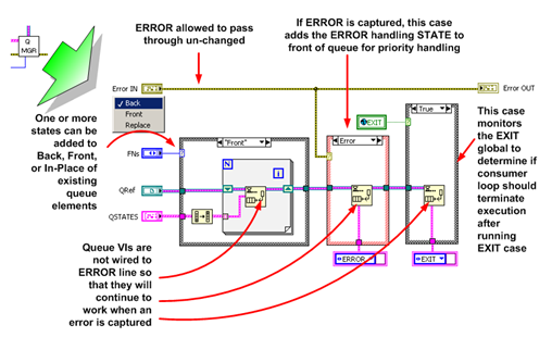

A Queue Manager VI is located right after execution of each individual case in the consumer’s state machine. See item 1.3 in Figure 2 and item 1.3 in Figure 3.  Note that this VI is strategically placed so that errors and commands can be capture upon execution of the individual state machine cases. The Queue Manager VI has three main purposes.
Figure 9. Queue manager VI executes after a state finishes running in the consumer process. This VI handles errors and allows run-time logic implementation, and monitors the need to exit..

(1)   Handle Errors From State Cases
Note that the queue VIs are considered ‘mission critical’ VIs and are therefore not wired to the error line. This allows these VIs to continue to work even when errors are captured by the queue manager VI. If such an error is captured, the ERROR state name is added to the front of the queue, see Figure 9. This forces priority processing of the shift-registered error before other states can run. You must clear the error in the error handler case.
(2)   Implement Case-by-Case Run-time Logic
The Queue manager VI can accept an array of STATE commands from any case in the state machine. The array-type input allows a state case to input no state (empty array), just one state (single element array), or multiple states. This avails the capability for consumer state machine case to implement ‘as-needed’ run-time logic. Run-time logic is where a consumer state case behaves as a producer by adding commands, as needed, to the queue for processing by the consumer loop. For example, a consumer state case after processing data from the queue can determine that an alarm condition needs to be raised. The state can then add the ALARM state name in the front of the queue or it can pre-empty all elements in the queue, and in their place, just add the ALARM state Name. The default is to add data packets to the back of the queue.
(3)   Monitor Global Exit
Monitoring the global EXIT condition only works if the VI is in constant polling mode. This can be achieved by forcing the consumer VI to visit the idle case at specified wait intervals. By doing this the queue manager VI can poll for the boolean EXIT global to determine if the consumer loop should terminate. If polling is not done, then the EXIT enum state must be input to the queue to instruct the consumer loop to exit.  Note that you could also make the de-queue VI come out of the wait state by closing the queue reference from another process in the code see Figure 10. All VIs waiting on the queue will come-out of the wait state and produce error number 1122. You can check for this error and terminate the consumer loop accordingly. However, this method of exiting from queue VIs’ wait state is not used in the QSM implementation of Figure 3.

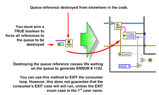

Figure 10. You can STOP the consumer loop by destroying the queue reference which causes VIs waiting on the queue to come-out of the wait state and generate a error #1122. An error state of TRUE from wait VI is used as a
condition for exit.

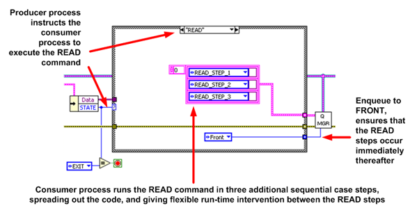

Figure 11. Consumer process case executing the READ command in three additional READ steps that will execute immediately thereafter by the addition of sequential READ steps to the front of the queue.

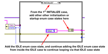

Figure 12. Example of how to perform continuous loops via the IDLE case state

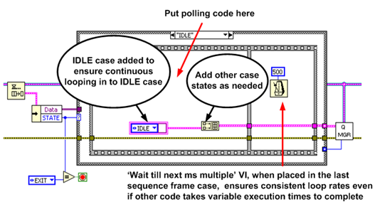

Figure 13.  Consumer process example showing how to code the IDLE case for continuous and constant loop cycle time. Note special use of the ‘Wait till next ms multiple VI’ inside a sequence frame.

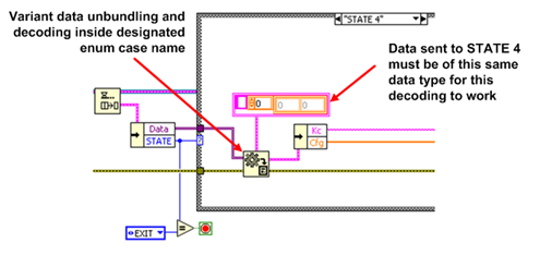

Decoding Data Packets Originating From Producer Processes
Producer processes send commands via the enum selector. Data of any type can be sent along with the commands by converting the data to a variant data type and then bundling variant data along with the enum command. However, for the consumer process to use this data, the data packet must be appropriately decoded from the variant data type. Variant data decoding must be done in the designated enum consumer case. Figure 12 shows variant data decoding in state machine case: STATE 4, of a data packet input to the queue as was shown in Figure 6(b) and Figure 6(c).
Figure 14. Decoding variant data inside STATE 4 for data that was enqueued from the
example in Figure 6(a) and Figure 6(b).
