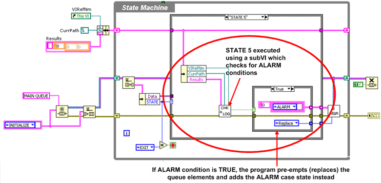

More on Run-Time Logic Implementation in Consumer Case
Each time a consumer state machine case finishes executing, there is opportunity for intervention of program flow by the addition of enum state commands at the back or front of queue or even to replace the queue elements with new enum command instructions. This feature, known as run-time logic programming is an important advantage of the QSM architecture. Figure 15 shows use of a SubVI to execute STATE 5. If the SubVI in STATE 5 can instruct detects emergency alarm conditions. The program will immediately pre-empt (replace) all enum commands in the queue and execute the emergency shut down enum case instead.
Figure 15. Run time logic programming with option to pre-empt program flow.

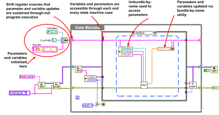

Avail and Update Parameters and Variables in Any State Machine Case
Another feature worthy of note in the QSM architecture is the shift registered cluster data flow line that passes through all state machine cases see Figure 16 (not shown in Figure 3). This flow line avails and allows update of parameters and variables as needed inside every state machine case. You use LabVIEW’s unbundled-by-name utility to access parameters and variables and use the bundle-by-name utility to update the same. Figure 16 shows these operations within enum case: STATE 6 of the consumer loop.
Figure 16. Shift registered cluster of parameters and variables that can be accessed and updated within every case of the state machine in the consumer process

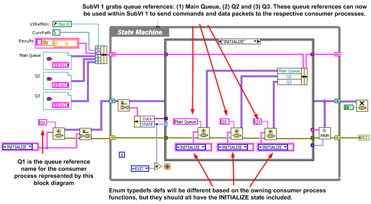

Building Both Multi-Consumer Functionality in LabVIEW Code
By creating multiple queue references of unique names you can have multiple consumer points in your LabVIEW code. Each consumer point (i.e.. at the dequeue VI) will own the respective queue reference of a unique name and will behave as the only destination point for all packets sent via that queue reference. In this way you can implement a network of transparent data migration paths from multiple producer points to predefined destination points in your code.  The one important rule here is that to send data to a given consumer point you must use the queue reference owned by the respective consumer process.
The example in Figure 17 shows a block diagram for SubVI 1 which behaves as a consumer process for the queue name: ‘Q1’ but which also grabs queue references: ‘Main Queue’; Q2; and Q3. In this case, SubVI 1 can use queue reference Q1 to accept commands and data from other producer points while and at the same time SubVI 1 can send commands and data to consumer processes that own the other queue references.
Figure 17. Block diagram for a subVI that behaves as the consumer process for Q1 but is also the producer process for queue references: (1) Main Queue; (2) Q2; and (3) Q3
