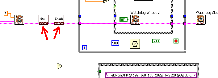

hi!
   I've also found that the two "whack" are not needed, they can be substituted by "START" and "ENABLE", that you can find in advanced watchdog functions. They're embedded in Whack function, that's why putting 2 whacks it worked!
   About your problem, I can't actually figure out what's going on... if it is a matter of driver, or a matter of device (I've tested on cFP-2120).
graziano
