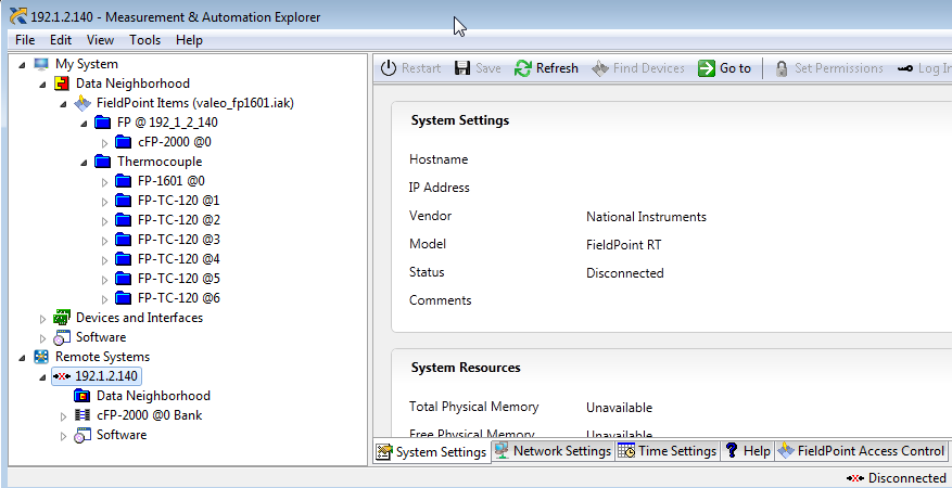

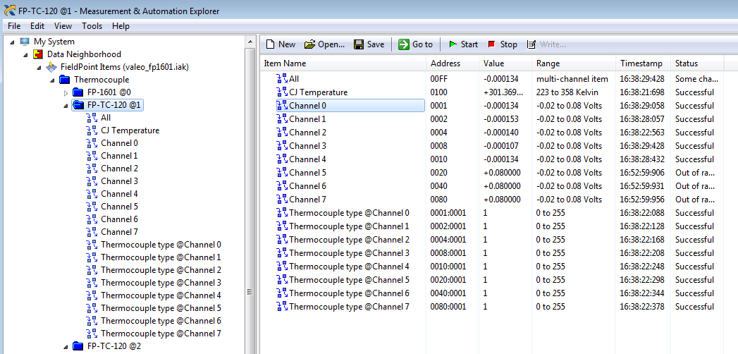

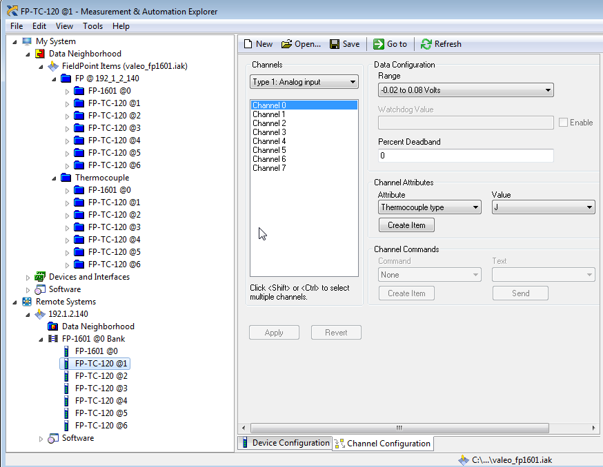

The main problem is that our Field Point FP-TC-120 lost the temperature range configuration and we could only read voltages. Even opening the file *.iak the temperature reading doesn't come back.
Screen Shot of the readings:

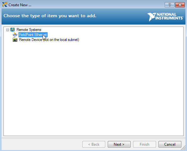

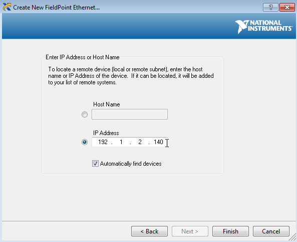

3- Add a new device:

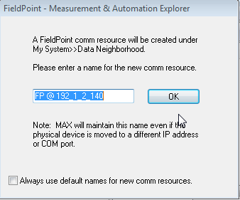

4- Place the IP address from cFP-1601 interface. On this example it is 192.1.2.140

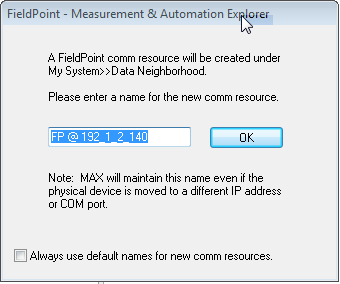

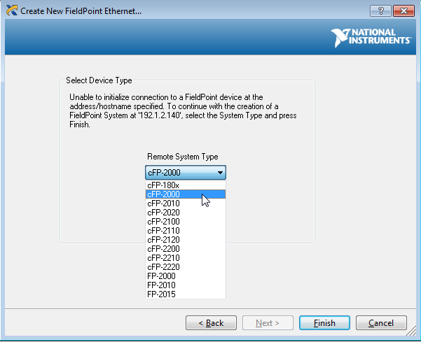

5- The following messages appears. Select Yes to create the Offline device.

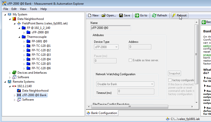

6- Select the cFP-2000 device and create the termocouples banks

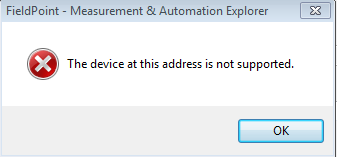

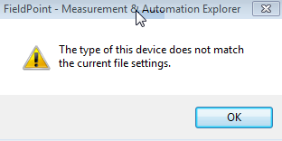

7- Select the cFP-2000 on Remote System. An error message will appear.

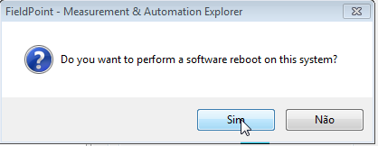

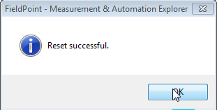

8- Make Hardware Reboot, clicking on Reboot button on top right menu. Even the device is disconnected, the Reboot command someway works.

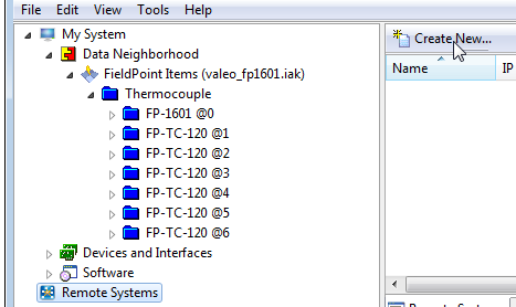

9- Remove the Remote System hardware again.
10- Add again the new hardware on Remote System (repeat steps 3 and 4).
11- Take care to not delay too much between the hardware removal and to add a new one.
12- When typing the IP address uses the "space" key to enter the numbers if below 3 digits. Maybe correcting the IP fails the next step. If it happens try again since the beggining.

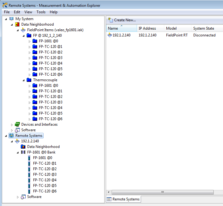

13- Here is the great difference: It creates automatically the cFP-1601 banks into Remote System on MAX 5.6.

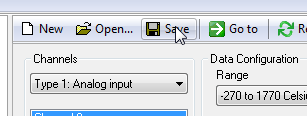

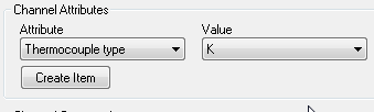

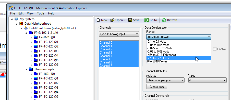

14- Then now it is able to setup the Thermocouples ranges and type as desired for each Channel, selecting the Channel Configuration Tab.
15- Now click on Apply button to save changes:
16- Repeat the step 14 for all the banks.

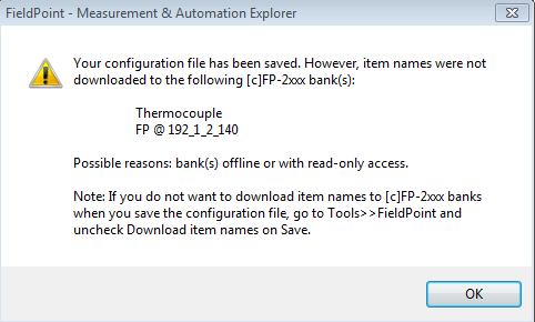

17 - After you can save the changes on *.iak file, but it is not well done. However it works. After reading again the *.iak file, it will not appears the cFP-1601 at Remote System. It is necessary to repeat all the procedure to access it again for channels configuration.
