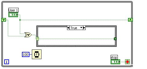

Since FielpPoint defaults to running at 100% CPU (see KB) I am not sure event based programming would be a big advantage.

With that being said you could do something like this.
