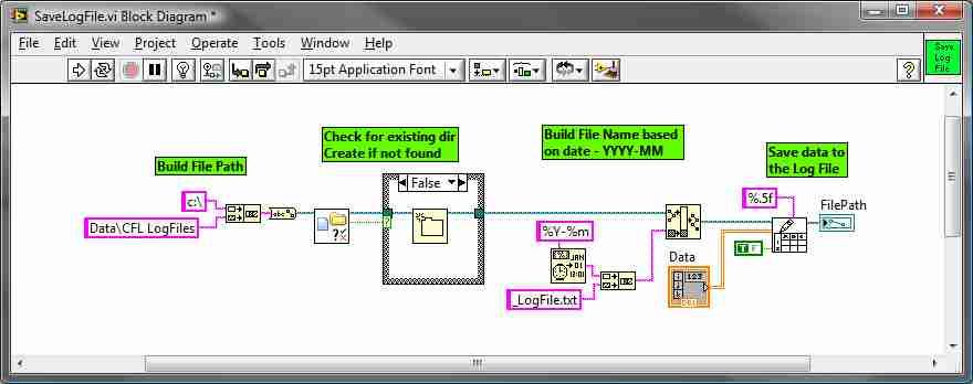

I am new to this and could not figure out how to post a vi or use the Insert Code feature.  However, It is a very simple vi so I just did a screen shot.
Don

FilterGeek,
I've attached my recreation of your vi.  It works just fine using LV 8.2 and cFP-2020.  Try running this on your cFP.  If it works, I suggest you look at your string constants and make sure you don't have any control characters hidden in any of them.

Hi FilterGeek
Your cFP-2020 and your cFP-2220 are actually running different operating system.  The cFP-2020 is using Phar Lap and the cFP-2220 is using VxWorks.
The two operating system use different path conventions.  Your specific issue is explained here.
Please let me know if you have any issues implementing the workaround that is listed in the article.

That was it.  I changed it to use the build path shown in the link and it works on both systems now...THANK YOU!!!
