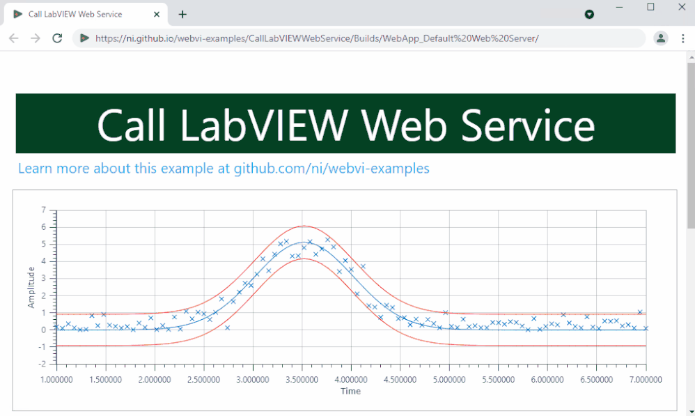

You'll need LabVIEW web service to do so.
refer to the G Web Example: Call LabVIEW Web Service you'll find FFT visualization there.
Screenshot
