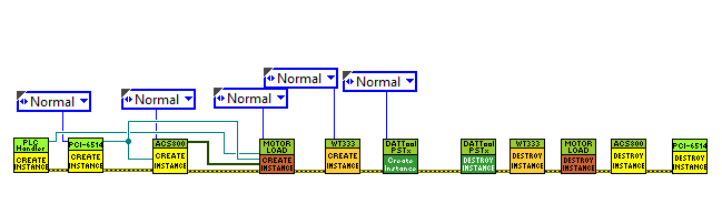

1) no change after recompile, same errors as before.
2) Works OK!
I'm using LV13.0f2 (32-bit), G# 1.6.4 and Win7 64bit
Part of the error message:
LabVIEW prevented a file name collision during the build. Duplicate file names cannot be copied to the same destination. You can rename files as part of the build process to avoid name conflicts.
The following files were moved to a unique location:
C:\...\Platform\Code\Testbed\class\MotorLoad_class\protected\ObjectAttributes.ctl
C:\...\Platform\Code\Testbed\class\ACS800_class\protected\ObjectAttributes.ctl
C:\...\Platform\Code\Testbed\class\MotorLoad_class\protected\ClassAttributes.ctl
C:\...\Platform\Code\Testbed\class\ACS800_class\protected\ClassAttributes.ctl
C:\...\Platform\Code\Testbed\class\ACS800_class\utils\Kernel.vi
C:\...\Platform\Code\Testbed\class\ACS800_class\utils\NotARefNum.vi
C:\...\Platform\Code\Testbed\class\ACS800_class\Destroy.vi
C:\...\Platform\Code\Testbed\class\ACS800_class\utils\ObjectAttributesRef.ctl
C:\...\Platform\Code\Testbed\class\MotorLoad_class\utils\ObjectAttributesRef.ctl
C:\...\Platform\Code\Testbed\class\ACS800_class\utils\ClassAttributesRef.ctl
C:\...\Platform\Code\Testbed\class\MotorLoad_class\utils\ClassAttributesRef.ctl
C:\...\Platform\Code\Testbed\class\MotorLoad_class\utils\Kernel.vi
C:\...\Platform\Code\Testbed\class\MotorLoad_class\utils\NotARefNum.vi
C:\...\Platform\Code\Testbed\class\MotorLoad_class\Destroy.vi
C:\...\Platform\Code\Testbed\class\ACS800_class\CreateInstance.vi
C:\...\Platform\Code\Testbed\class\MotorLoad_class\CreateInstance.vi
C:\...\Platform\Code\Testbed\class\ACS800_class\Instance.vi
C:\...\Platform\Code\Testbed\class\MotorLoad_class\Instance.vi
C:\...\Platform\Code\Testbed\class\ACS800_class\DestroyInstance.vi
C:\...\Platform\Code\Testbed\class\MotorLoad_class\DestroyInstance.vi
C:\...\Platform\Code\Testbed\class\MotorLoad_class\properties\mode\Getmode.vi
C:\...\Platform\Code\Testbed\class\WT333_class\properties\mode\Getmode.vi
C:\...\Platform\Code\Testbed\class\WT333_class\utils\ObjectAttributesRef.ctl

Well, it seems like the G# parts work. The renaming and moving is as it should be. It will be like this in a build when there are files with identical parts. Thats just the way LabVIEW classes behaves in builds. By default LabVIEW places every file in the "root" of an exe, but if there are collisions between files, they will be moved like you se above.
I still think you have some problem with LabVIEW code, like the drivers you are using for your motor load ACS800. You need to isolate what is causing LabVIEW not to build. Try the following:
1) Try making just a simple VI without any classes and just put the communication code from your ACS800 directly in this and try to build.
2) Remove the ACS800 from you large project (I assume this is a subclass of MotorLoad) and try to build.
This way you can try to narrow down to what part of your code that causes LabVIEW not to build.
A general tip is that I almost always try to follow, is to build very often, even when project is not finished. As soon as I have the first compilable code, I build even if the resulting executable is useless, but I will very early in my project find issues that may cause problems during builds that I can deal with directly and it is not that fun to find these late in the project close to a real delivery.
