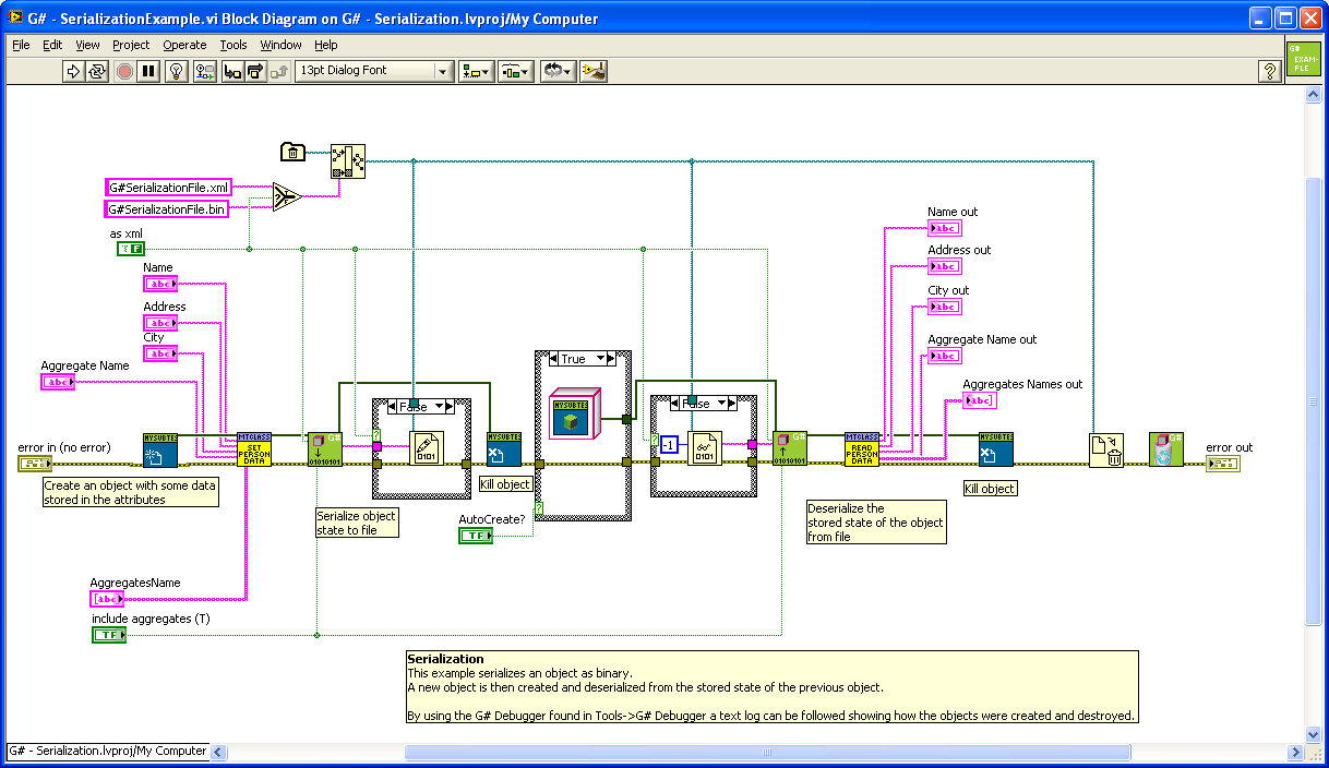

Since this is a recursive call, you can provide a mix of the above options. I made an example where I have three classes, one class "TestClass.lvclass" that aggregates objects from "MyAggregated.lvclass". Then I have a class called "MySubTestClass.lvclass" which inherits the TestClass.lvclass. This way my example tests both aggregation and inheritance at the same time.
However, I did some testing of this and actually found out that it doesn't work as expected. My serialization of aggregates isn't working for this complex situation, so therefore I have rewritten G#Serialization and G#Deserialization VIs. I also removed XML support for aggregated objects, this is really difficult to implement, so for now, only binary serialization is supported for aggregation of object.
I made a new built G# 1.3.5 (notice that the G# IDE has a different version, same as G# Framework) that I will include in the next release of G# Framework, but I attach it here and you could manually replace the folder <LabVIEW>/vi.lib/addons/_AddQ/G#Object.
When you run this example, an object will be created which aggregates three other objects. Then this object is serialized to file recursively and the objects destroyed. Then you have an option, either you create an new object and deserialized this or you just put in a LabVIEW class constant (for type only) and the lets the serialization VI create the needed objects from the serialization string.
