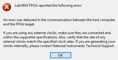

     I was trying to use fpga to connect to a highspeed adc, running at about 100M, and I'd like to use the built-in clock function to trig data read out.
     Because if I read out the data from adc with my on clock, I will have to over-sampling the input clock at least of 2 times of real adc sample clock, I can use the clock generate loop as read out time base, but it wouldn't provide much margin of error if the system parameter changes slitly.
     The ADC itself already provided a clockout pin, and can be adjust at 8 different phase, which is very handy if I can use this clock to trig my read out code, but at there I met a problem.
     The code can compilation, but eventime I try to run the code, it says I don't have a input at some clock in port. which is true since I will have my FPGA running then I will have clock exported to ADC, and after data is convented, ADC will provide clock back to FPGA.

Hi Jiangliang,
Can you confirm your connections and clock pins in the LabVIEW code?
In your screenshot, you mention that you have wired a jumper from PMOD4_PIN8 to PMOD4_PIN7.  PMOD4_PIN7 is "DIO_38_MRCC" but it appears the pin used for the clock in the GetClock loop is "DIO_36_SRCC".  I'm afraid you may have crossed DIO_36 and DIO_38 unintentionally in software, as both pins are clock capable and similarly named.
In gereral, I don't believe the external CLIP clock has to be glitch free or continuously running, but your code must be able to deal with those issues.  I'm not sure if additional constraints are applied when that CLIP clock is routed to the LabVIEW FPGA diagram.  I'm hoping someone on my team can add a more definitive reply, but I wanted to post as quickly as I could to point out the potential wiring issue.

I believe that imported clocks must be running when the diagram starts up, otherwise you will see that error. I recommend that you keep all clocks running at all times.
It looks like you are importing a clock correctly, but it looks like you are exporting a clock incorrectly.
You say that you want a clock that is running around 100MHz. In your diagram, it looks like you created a clock divider circuit with a register that takes a 288MHz signal and divides it down to 144MHz and you send the signal into the CLIP. LV FPGA and the synthesis tools handle clock signals and data signals differently, so I recommend that you export your clock signal as a clock instead of a data signal.
If you would like to create a 144MHz clock from a 288MHz clock, I recommend that you right-click a clock you would like to derive from and click "New derived clock". This will instantiate an MMCM in your diagram logic and produce a clock signal and LV FPGA and the synthesis tools will handle correctly.  Xilinx MMCM's will produce a higher quality clock signal and will include your clock signal in it's timing constraints.
If you would like to export a clock in your LV FPGA project to a CLIP, use the sbRIO CLIP Generator to add a ToCLIP clock. It looks like you already added a FromCLIP clock named Clock_36_SRCC. The process is very similar, just assign it to go the other direction. Exporting clocks do not need to use clock capable pins. The socket property page has a page about clocks. From there you can choose which clock from your project to assign to the CLIP. If there is a clock in your project that meets the requirements defined in your CLIP, then I believe it automically assigns it.
I would do a clock loopback test to see if everything is working correctly. Connect your exported clock to your imported clock and make sure that works correctly. If that is working properly, then you can try putting the ADC between the two clocks and check to see if it still runs correctly.

Jianglang,
To add a little to what Spex was saying, the external CLIP clock doesn't have to be glitch free or continuously running, the specific reason that error is being thrown is that you have an indicator inside that single-cycle timed loop. When you run the code interactively, LabVIEW is trying to read all indicators and since that one's in code that hasn't executed yet, it throws that error. If you don't run the code interactively, and only read that indicator once the clock has started you shouldn't see that error, additionally if you replace the indicator with something like a FIFO (see below) the error won't be thrown as well.
