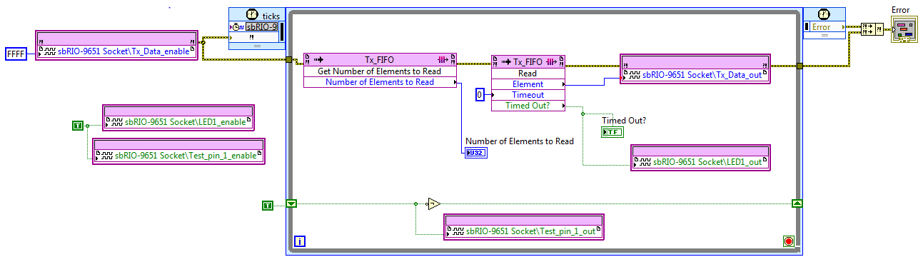

I'm using an sbRIO-9651 with its carrier board and try to execute this simple fpga vi. The SCTL is clocked with a 1MHz external clock. The RT side keeps writing integers in the DMA fifo (Tx_FIFO).
When I probe the Test_pin_1 with an oscilloscope, i'm measuring an unstable square signal with something like 515KHz frequency. Shouldn't it be half the loop clock instead (500KHz) ?
Any idea of what i'm missing.

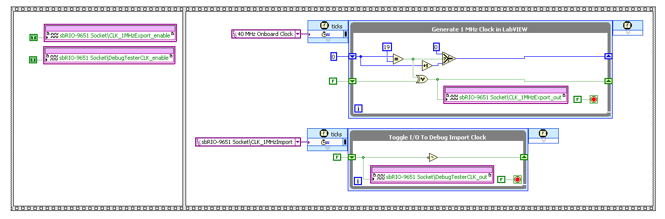

I tried to reproduce something similar with your setup so I created a 1 MHz loop by dividing the 40 MHz base clock on the sbRIO-9651 down by 20 to output the correct clock frequency -- this was all in LabVIEW FPGA (see the below code).

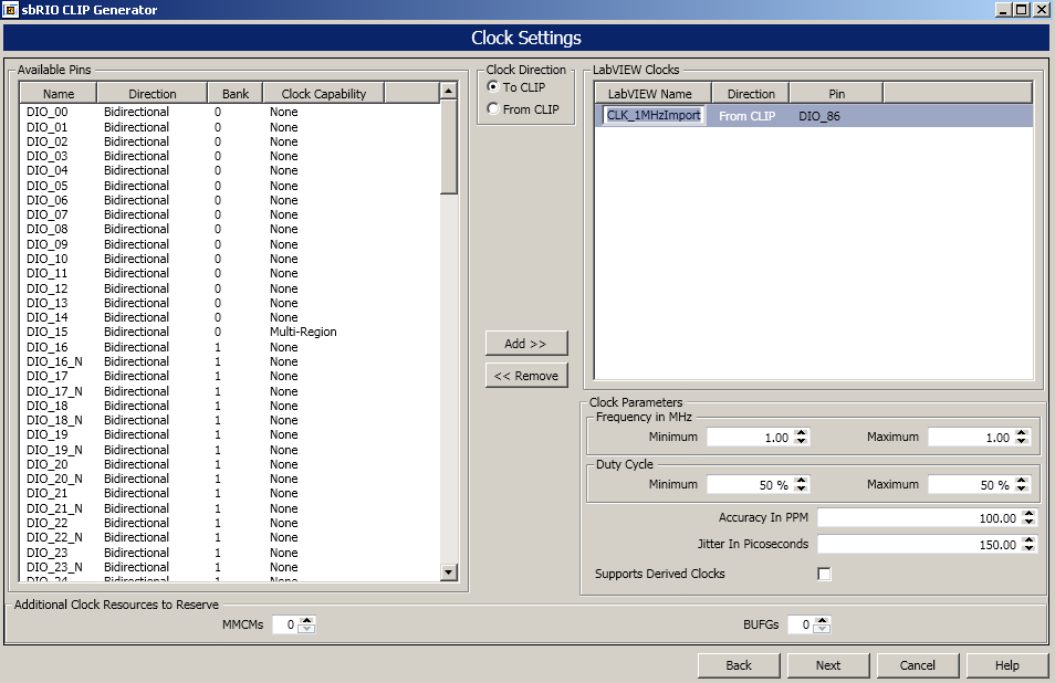

In the sbRIO CLIP Generator, I created an imported clock and specified it to be a 1 MHz clock. This is so I can output a 1 MHz signal and wire feed that signal into my imported clock pin that is an MRCC pin on the sbRIO-9651.
Below is the CLIP Generator configuration for my imported clock.

If you are generating a clock source from LabVIEW FPGA, make sure it is generating the expected output frequency. For example, if you are using a 80 MHz clock for an SCTL and you divide down by 40 to create a 1 MHz clock, make sure it is actually dividing by 40 instead of 39. That would create an overall output of ~513 kHz which close to your actual result. I doubt this is the cause but wanted to bring it up.
LabVIEW-Created 1 MHz Clock (This signal is not terminated so the SI looks pretty bad).
Debug Output on the lower loop running at 500 kHz (This signal is not terminated so the SI looks pretty bad).
Code used to create this example
Things to note: I tried mimic your overall architecture to try and reproduce similar results. Ideally, I would set the output enable that corresponds to the lower loop in the same clock domain by creating a simple state machine that first configures the directionality, then goes on to read/write the value. It didn't seem to make a difference in this case but something to consider.
