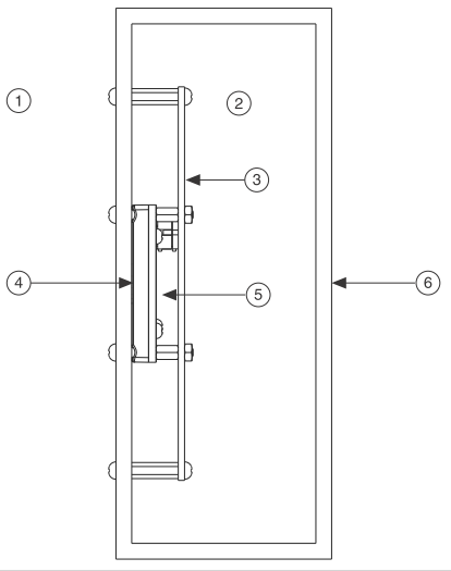

I did notice NI did quite a lot job on SOM heat performance, but now I have to build my own chassis, I did like what NI recommanded my to do, put the SOM direct contact to the chassis, yet the chassis itself is not very big, and I would like to have a idea about the worst condition heat manage performance.
I have some idea, but not quite sure if it covers all:
1. make RT running at 100% cpu, for both core.
2. at the same time, make memory bandwidth usage at a high level, which make sure memory controller and memory itself are fullly loaded.
3. also make flash running at a high level usage
4. make a near 100% usage code at FPGA, and make it running at a high frequency, like 160Mhz or so.
Am I doing that right? Or maybe someone can tell us how NI did their heatsink performance benchmark? Maybe NI can provide something like SuperPi in PC benchmark?
