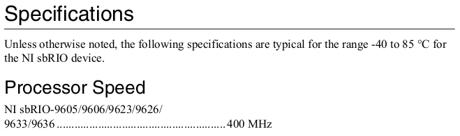

Hi Terry, this is the closest thing to a spec that I found:
So the question may be, how many clock cycles does it take for the RT Host (to be precise, its RT OS) to grab the data from the FIFO?

That is not the spec I would use for this.  PXIe chassis have throughput specs but I cannot find one for this product.
I did find a similar discussion on the topic which quotes throughput at 300 MB/sec so you should be fine.
