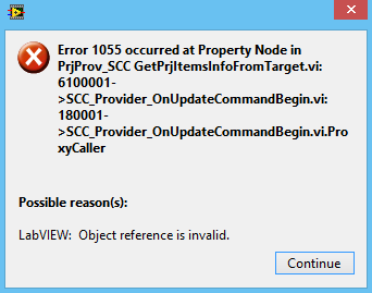

The second problem is I need to get ProjectItem reference to each file in the list of dependencies.  To do that I'm using AB_API Get Project Item Reference.vi, similar to how Darren is using it in the example code.  Unfortunately, nearly half of the dependencies are being returned with the ProjectItem reference not found, and since I've start using that vi I've been getting a perpetual error somewhere from the bowels of the system:
This error is occurring when my build script is paused and I try to view the project my script is using.  It usually ends up crashing Labview or locking it up hard.

I took a look at the diagram of AB_API Get Project Item Reference.vi. It doesn't do the best job of closing references...I don't know if that could be the cause of the 1055 error, but it wouldn't hurt to try a more robust version of the VI. I have posted one here. It is saved in LabVIEW 2013, no password, and it closes all the ProjectItem references it opens:
