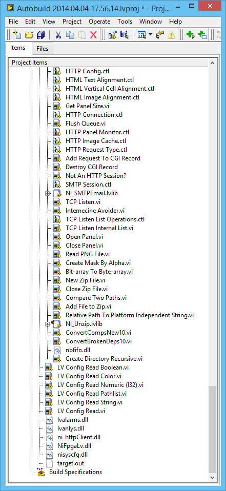

Thank you very much Stephen, that is *exactly* what I needed.  Creating the build project used to be a 45 minute process... now it takes about 5 minutes.
I still have to iterate through refreshing dependencies and adding them to the project 3-4 times before refreshing doesn't add any more dependencies to the project.  Granted, after the first pass of gathering dependencies most of the remaining dependencies look like pretty obscure low level things from NI.
These are shots of the dependencies that were collected on the second and third passes.  It's pretty clear at some point LV decides to quit populating the dependency folder.  I don't object to that behavior--I just need to understand what those cutoff points are.
