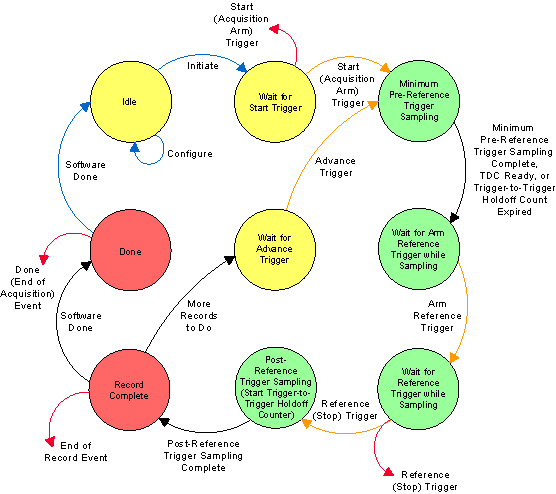

Good questions, how familiar are you with digitizer/oscilloscope acquistion?  For digitizers/oscilloscopes, they typically acquire a set number of points, called a record.  Thus the record length property is the number of samples you want to acquire in a single acquisition.  Each record is distinguished by a reference trigger, like an edge trigger for example.  By default, the reference position is 50%, which means that half of the samples in a record are before the trigger event, and half are after.  These are called pretrigger samples and post trigger samples respectively.
On a box oscilloscope, it continuously acquires records, and displays them on the screen.  For digitizers, you have a little bit more control, and you can acquire a single record (single shot), or mutliple records.  You can see this in the following State Diagram:
http://zone.ni.com/reference/en-XX/help/370592E-01/digitizers/5122_state_model/
By default, NI-SCOPE will acquire a single record, which will travel on the outside circle of the state diagram states.  If you configure more than one record using "Number of records", then you will travel on the right state cycle, going through the middle state until all the records you have set to acquire have been acquired.  This means that you will obtain multiple records (with the record length being the number of points to acquire).
Anyway, to answer your question, record length is the number of samples you want to acquire, which means you will need to set it to 400.  From your description, you just want to acquire one record at a time, so set number of records to 1.  Then to obtain multiple records, just call niScope Initiate.vi, and that will initiate another acquisition, acquire your record, and then go back to an idle state while you fetch the data from the hardware.  I'm assuming by "at any given time" you mean that you are doing some sort of software timing (ie start an acquisition on a button press).
