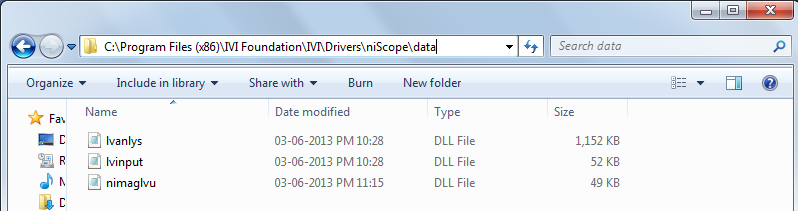

file size of the NI-SCOPE Soft Front Panel.exe located in C:\Program Files (x86)\IVI Foundation\IVI\Drivers\niScope  14297KB
what files are located in the C:\Program Files (x86)\IVI Foundation\IVI\Drivers\niScope\data directory.  There should be three of them.
Date looks old shouldn't it be today's??

The dates in the screenshot are correct, they are the dates when the DLL files were packaged into the installer, not when they were installed onto your system.
