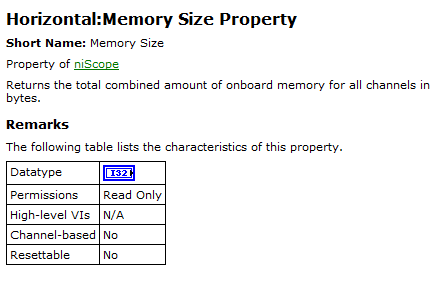

I apologize I did not realize you already had the card.  There is a property node for NI Scope to determine the total amount of available memory that we can then divide down to get the available memory per channel.  Please see the vi and help below:
Give this a shot, just drop it into an existing VI that you are using and it should return your cards memory.  If you do not have LabVIEW I can most likely retrieve the version you purchased by querying your Serial Number.
