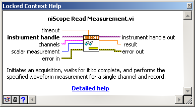

Digg into the manual of NI-Scope and you find
the scalar measurements provide a list of supported on board measurments including Peak-to-Peak-Voltage ...

Set up a ni-scope task and configure the samplerate at least n=20 times the measured frequency with at least 2n samples , then instead of reading the waveform and analyze it by your own,  use the vi noted and you get the peak to peak value. Divide it by 2 and you have the amplitude 🙂  (and you compensated a possible offset at the same time 😉 )
