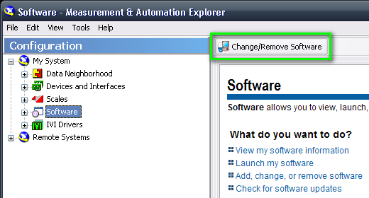

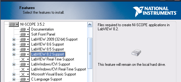

Additionally, you may try going into Measurement and Automation Explorer (MAX), clicking the software button on the left under the Configuration » My System tree, and then clicking the Change/Remove Software button (please see first image below). This will bring up a dialog with a long list of National Instruments software. If you select NI-SCOPE 3.4, you can then select the Modify button to the right and this will bring up a list of what is installed from the driver as far as support for each development environment. Please ensure that LabVIEW 8.0 support has been installed here.
For your particular version of LabVIEW, you will want to stay with NI-SCOPE 3.4 as the newer versions of NI-SCOPE 3.5.x do not contain support for LabVIEW 8.0 (current versions of DAQmx do not support LV 8.0). Hope this helps,
